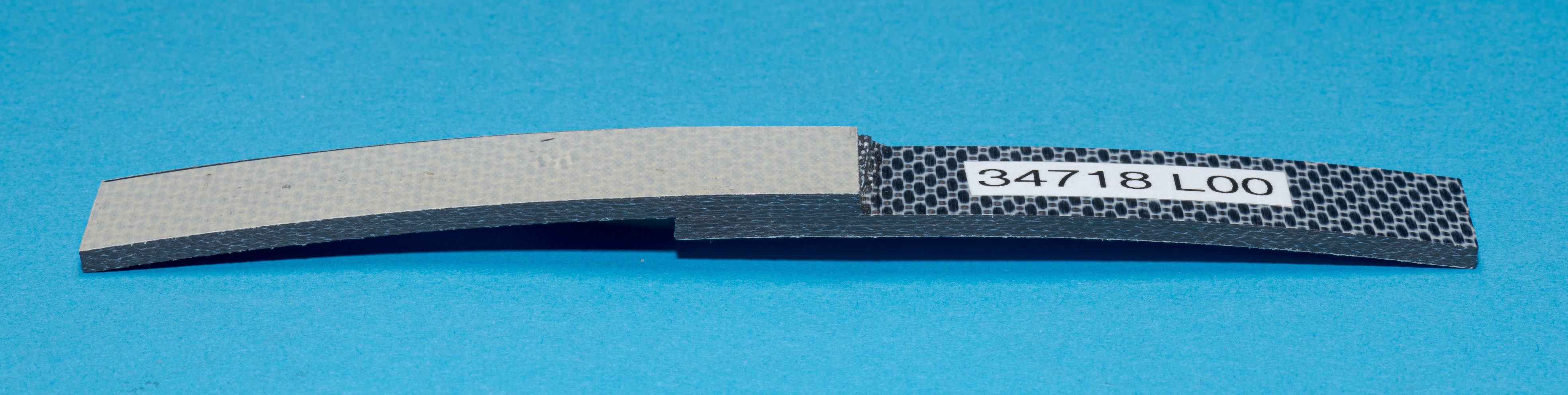

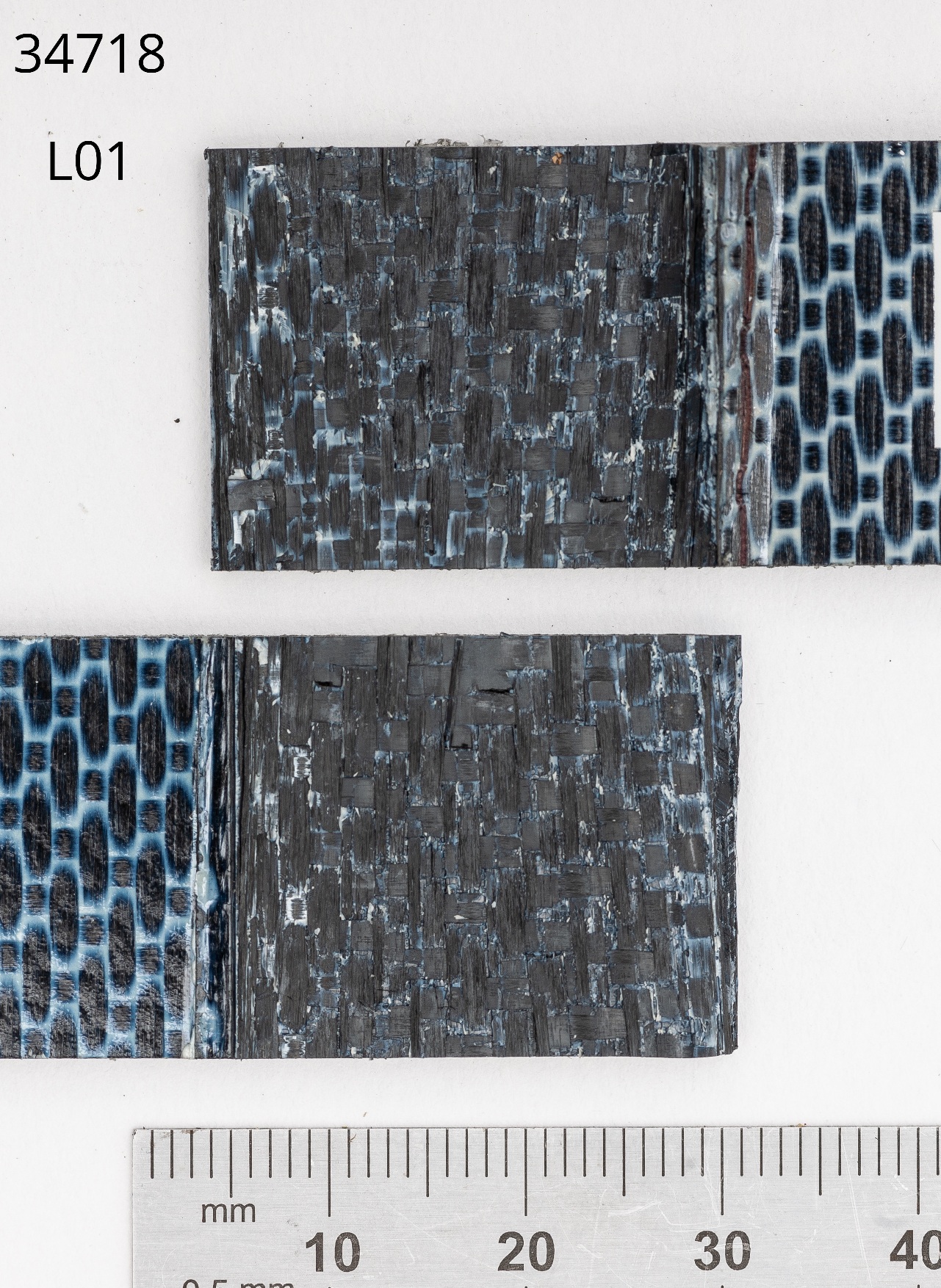

  • Demonstrated a capability to weld 3D (curved) geometries, and the ability to weld element level components relevant to industry
  • Demonstration of producing 3D geometry welds with equivalent strength to 2D (flat) joints

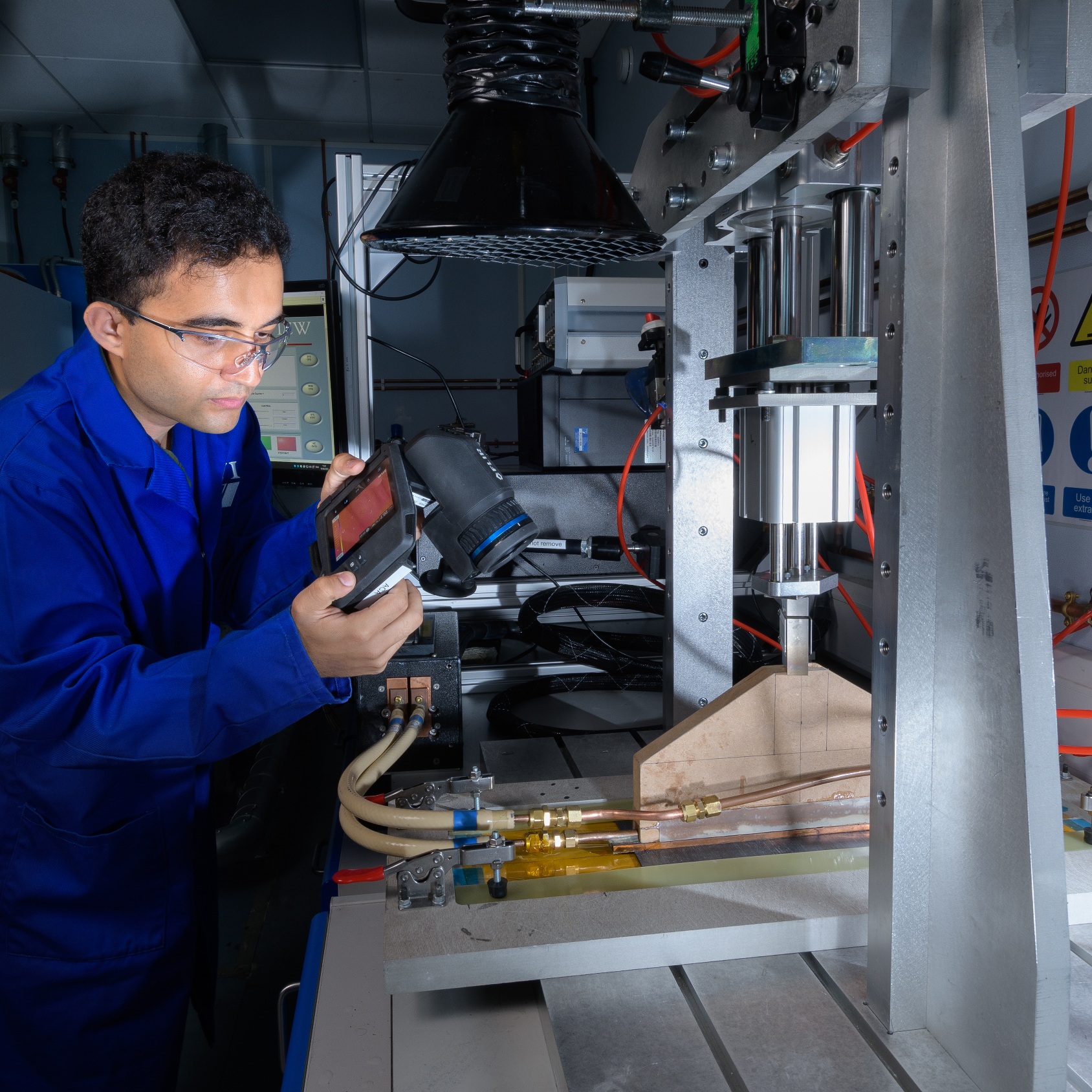

  • Demonstrated the adoption of elements of automation to the welding process that is appropriate to industries requirements for high volume/high quality composites joining
Impact
The project has met the three main objectives set out at the start; TWI’s has a capability to perform 3D (curved geometry) thermoplastic composite welding with equivalent strength values reported compared to baseline 2D (flat geometry) welds. A level of automation has also been demonstrated through the incorporation of thermal imaging control of the process.

Figure 1: Set-up for 2D joint manufacturing (copyright TWI Ltd)

Figure 2: Side view of 3D single-lap shear specimen L00 (copyright TWI Ltd)

Figure 3: Fracture surface of specimen L01 (copyright TWI Ltd)
