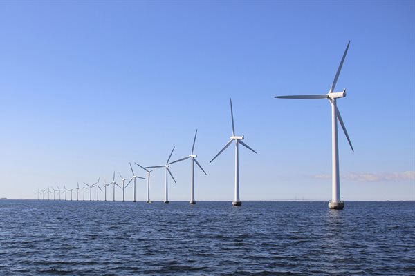

TWI has been involved in, and continues to work on, a large number of projects related to the development of SHM systems. These are designed to focus on a range of different structural types including surface transportation systems using composite materials, wind turbines, aircraft structures, tidal stream power generation systems, storage tanks and bridges.
