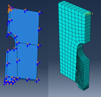

  • A modified geometry and a recommended maximum thickness of 30mm for the reduced section tensile test specimen is proposed.
  • For butt fusion joints with a pipe wall thickness greater than 20mm, the modified specimen geometry significantly increases the ductility and energy to break per unit cross-sectional area.
  • Although the modified geometry for specimens from butt fusion joints with pipe wall thickness below 20mm does not improve the ductility, it significantly reduces the elongation in the loading holes and therefore results in a more representative value of energy to break per unit cross-sectional area, without the need for an extensometer.

Finite element analysis boundary conditions and meshing size used for determining the effect of width of the waisted section and loading hole diameter on the elongation in the loading hole
1154-2021-Fig 17
