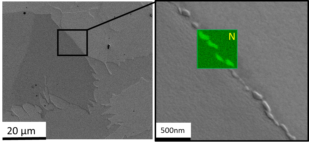

However, better understanding of the role of different phases in parent/weld metals and heat affected zone (HAZ) of DSSs on localised corrosion and environmentally-assisted cracking (EAC) in chloride-containing environments, is needed. The current project has focused on understanding the relationship between localised corrosion, EAC and microstructure susceptibility, especially HAZ microstructural features. Application of tools such as Gleeble simulation and scanning Kelvin probe force microscopy (SKPFM) were employed to simulate HAZ microstructures and to identify the inherent anodic and cathodic behaviour of different precipitates in the weld/HAZ, and the change of the electrochemical behaviour with environmental exposure time.

  • Chromium nitrides were found in the simulated HT-HAZ, although their appearance is normally associated with low heat input and reduced austenite content. Despite the advantage of a coarse austenite morphology, the corrosion properties could be compromised by Cr2N, potentially offsetting any benefit.

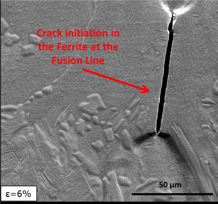

  •  Hydrogen-induced stress cracking in DSSs is strongly driven by the ferrite content and morphology, with intragranular austenite and grain boundary austenite offering limited cracking resistance in the regions where the austenite fraction is heavily reduced.
  • Coarser austenite grains are beneficial to HISC resistance but austenite can also become embrittled in environments in which hydrogen recombination poisons are present and/or high charging currents are employed.

 Chromium (II) nitrides at the ferrite-to-ferrite phase boundaries. Overlapped, nitrogen elemental mapping with windowless EDX.

Quasi in-situ SEM straining of specimen taken from a TIG-welded pipe. Detail of the HAZ with crack nucleation at 6% strain.
