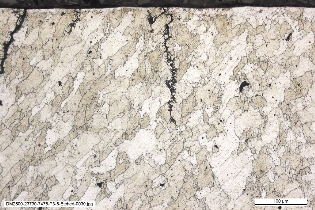

  • The range of welding parameters employed had some effect on microstructures, tensile properties and weld formation in friction stir welds in 7050 and 7475 aluminium alloys, but no effect on corrosion behaviour of the welds was detected.
  • FSW of the aluminium alloys creates some sensitivity to SCC and intergranular corrosion (IGC), using both low and high heat inputs. The changes in welding parameters did not affect the corrosion sensitivity of friction stir welds in high strength aluminium alloys. Without PWHT, the narrow boundary zone at the edge of the TMAZ was the region most susceptible to IGC.
  • Eight PWHT procedures were applied to FSW aluminium welds, with one being particularly effective in improving SCC resistance for both alloys.
  • Alternative PWHTs were found to be effective in improving SCC resistance, at either 50 or 90% of the parent metal proof stress, for 7475 welds.
Section of 7050 aluminium alloy tested SCC coupon etched in Kellers’s reagent
1133-2020-Image01
Transverse section of aluminium alloy 7475 SCC coupon etched in Keller’s reagent: cracking in the TMAZ
1133-2020-Image02
