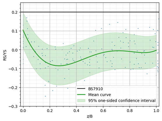

  • Using suitable statistical analysis, it has been observed that BS 7910 upper bound fit is conservative with respect to a 95% one-sided confidence, see Figure 1.
  • The BS 7910 Level 2 curve for low heat inputs is conservative with respect to 95% one-sided confidence, see Figure 2.

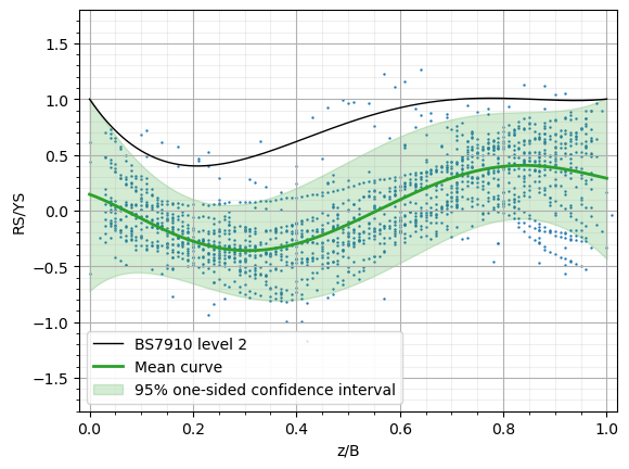

  • When PWHT has been applied, using the BS 7910 rule of 20% of the lesser of the yield strengths of the weld or parent metal, BS 7910 is conservative with respect to 95% one-sided confidence.

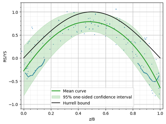

  • EB welds exhibit significantly different residual stress profiles from those of multi-pass arc-welded joints, with a peak tensile stress observed at ½ or 2/3 thickness and compressive stresses at the two extremes of the section thickness.
  • The recommended WRS profiles proposed by Hurrell et al (2014) for ferritic welded plates is potentially non-conservative with respect to 95% one-sided confidence, especially when considering z/B ≤ 0.5.

Upon completion of statistical analysis, it shows that the PWHT WRS rules given in BS 7910 are conservative. This is consistent with TWI’s experience and previous analyses.
Based on the limited data, this work demonstrated that the literature EB WRS profile (proposed by Hurrell et al (2014) for defect assessment) is potentially non-conservative especially when flaws are located at z/B ≤ 0.5 and should be used with care.
1206-2024-Figure 1
Figure 1: The mean curve for low heat input residual stress along with the 95% one-sided confidence interval and the BS 7910 level 2 upper bound fit
1206-2024-Figure 2
Figure 2: The mean curve for PWHT residual stress along with the 95% one-sided confidence interval plotted with the BS 7910 (BSI, 2019) 20% YS rule
1206-2024-Figure 3
Figure 3: The mean curve for EB plate residual stress along with the 95% one-sided confidence interval plotted with the proposed upper bound profile by Hurrell et al (2014).
