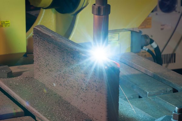

Arc additive manufacturing, also known as wire arc additive manufacturing (WAAM) and directed energy deposition-arc (DED-arc), is a 3D printing-type production process that can be used to create parts by depositing layers of metal wire on a substrate.

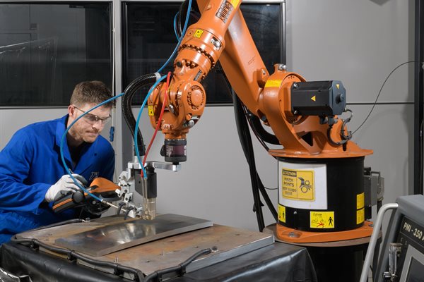

WAAM processes use an electric arc to melt a metal wire feedstock and deposit it layer-by-layer to build a 3D object. It is a form of directed energy deposition (DED) that bears similarities to traditional arc welding, except it is automated by a computer-controlled robot or gantry system. It is a cost-effective manufacturing technique able to produce large-scale metal parts with a high deposition rate.
The process works as follows:
  • An electric arc is used to melt a metal wire which is then fed into the arc
  • The molten metal is deposited layer-by-layer on the substrate to build up the part according to a path defined by a 3D CAD model
  • A robotic arm or gantry system moves the welding torch to control the placement of the material to build the final component
