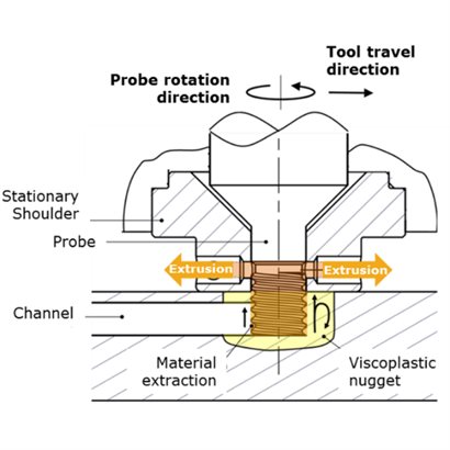

CoreFlow® tooling description and main process parameters
TWI invented and patented a new stationary shoulder variant of FSC (SSFSC) which has proven to overcome many of the drawbacks of conventional FSC. A stationary shoulder is employed to confine the nugget of viscoplastic material, limiting the flow of material extracted by the probe. With the appropriate rotation direction, the geometrical features of the probe cause part of the nugget material to be conveyed into the shoulder. The material extracted is then re-directed towards a series of vents in the shoulder and expelled.
As the tool assembly traverses along a pre-defined path, the process of extracting the material leads to the formation of i) a closed channel within the workpiece and ii) the production of extruded wire. Process parameters and tool designs are combined such that the rate of material extraction per unit distance is limited to maintain a fully consolidated channel ceiling.
The cycle is initiated by plunging the rotating probe into the plate. Once the probe reaches its target plunge depth, the machine initiates its traverse motion. As the tool traverses along the workpiece, the plasticised material is conveyed upwards by the rotating probe threads, into the shoulder and then expelled as extruded material. This subtraction of material leads to the formation of a closed sub-surface channel.
