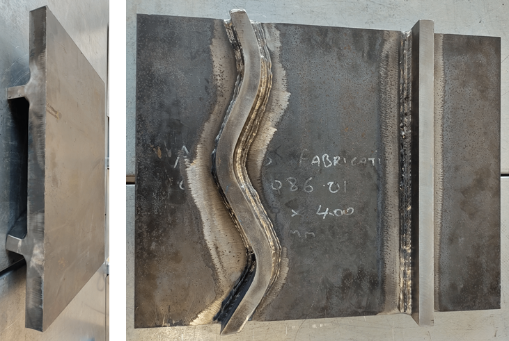

The aims of the project were met, as a system was developed which can scan an unknown weld geometry. The system was also cobot deployed and maintains contact with the surface while the probe traverses the component. The system also updates the probe position and skew based on the ultrasonic feedback. This was proven on an ‘s’ weld, however further work is required on the skew aspect for other scenarios.

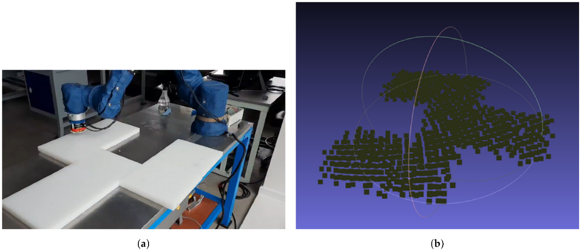

 1201-2024-Figure 2
Figure 2 Demonstration of CFSA [1]
1201-2024-Figure 3
Figure 3 Demonstration of complex curvature with CFSA

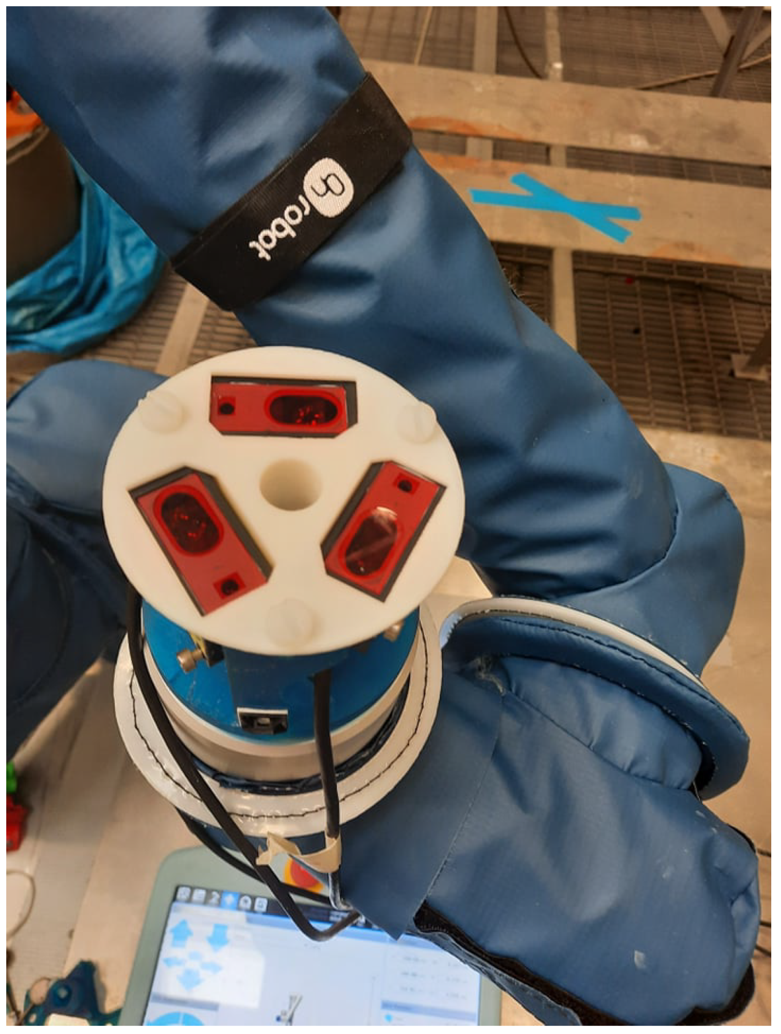

1201-2024-Figure 4-resized
Figure 4 Tri-laser holder, attached to the UR10e flange. The design with rotational symmetry around axis 6 of the robot minimised the footprint of the tool.

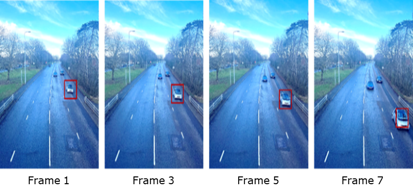

1201-2024-Figure 9
Figure 9 Tracking example by using meanshift algorithm

1201-2024-Figure 11
Figure 11 Weld plate with fillet welds
