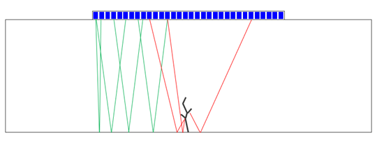

This report presents neural network models and their performance in measuring the TWE of cracks in specimens. The models were created using experimental data and simulation results. In industry there can be insufficient data from real cracks to create the models because cracks tend to be rare and, even when found, the data is typically not available for various reasons. Therefore, a hybrid approach was investigated to develop the models using simulated results and a relatively small dataset from specimens containing representative cracking. The innovation introduced in this report is the feature engineering concept using the so-called snooker algorithm. The combined performance of two types of neural network models using the so-called snooker images was found to be sufficient.

  • Neural network models can be developed successfully to perform through-wall extent sizing of surface-breaking fatigue cracks. This was made possible by feature engineering through a new imaging technique termed snooker developed for this purpose. The snooker algorithm leads to an image that is ideal for input to neural network models.

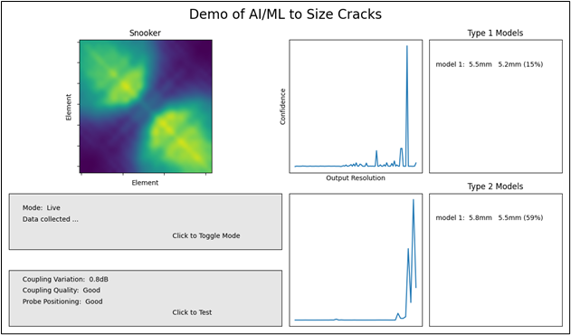

  • Many factors can affect the predictions of models during inspection and therefore a statistical approach (eg averaging of multiple test results) to processing their output is necessary and this report shows that this led to a sizing accuracy within 1mm. The use of many models with individual observed characteristics may provide confidence in processing predictions in more complex inspection scenarios.

1219-2026-Fig1
Figure 1: Snooker algorithm
1219-2026-Fig2
Figure 2: User interface to AI/ML model to measure crack size
