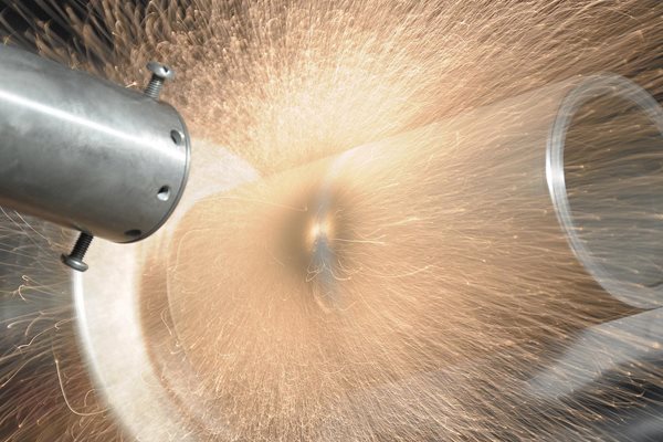

In the Cold Spray process, powder particles (typically 10 to 40 µm in size) are accelerated to very high velocities (200 to 1200 m/s) using a supersonic compressed gas jet at temperatures below their melting point. Upon impact with the substrate, these particles undergo extreme and rapid plastic deformation, which disrupts the thin surface oxide films present on all metals and alloys. This deformation allows intimate conformal contact between the exposed metal surfaces under high local pressure, facilitating bonding and enabling the rapid build-up of thick layers of deposited material. Cold Spray has diverse applications, such as repair, functional coatings, and additive manufacturing for various industrial sectors.

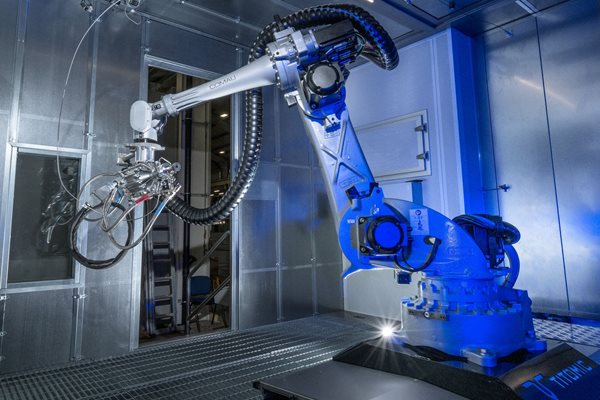

TWI uses high-specification commercial systems, including:
  • Titomic 523: A manual/portable low-pressure cold spray system that uses compressed air as the process gas, capable of operating at pressures up to 6 bar and temperatures up to 600°C.
  • Impact Innovations 5/11, and Titomic TKF-1000: High-pressure cold spray systems offering higher operating temperatures and pressures (with N₂ gas at up to 1100°C and 60 bar), delivering enhanced coating quality. These systems can be operated with or without pre-heating the gas and with a variety of spray nozzles, allowing for configuration based on specific requirements.
