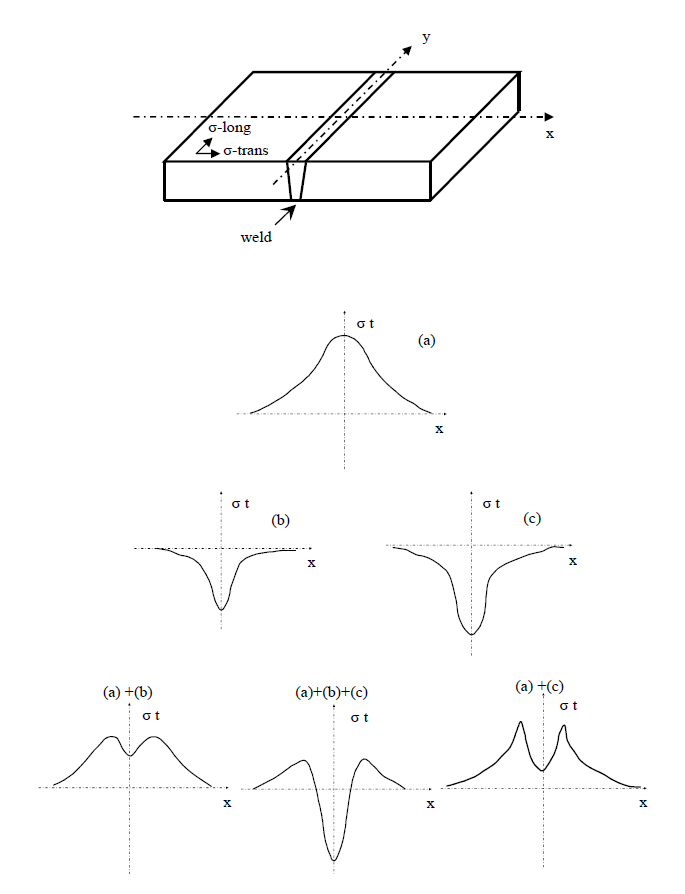

 1110-2019 Image 02
Linear superimposition of transverse residual stress resulting from welding:
(a) Shrinkage
(b) Quenching effect
(c) Phase transformation
[From Macherauch E and Wohlfahrt H, 1977: ‘Different sources of residual stress as a result of welding’, in Residual stresses in welded construction and their effects, Vol 1, R W Nichols (Ed), The Welding Institute]
