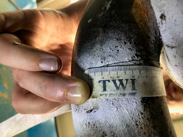

  • Fatigue failures were observed at several different locations in a link including the transition point at the inner radius of a link, the crown region, the weld, the stamping mark and the straight bar, with most cracking occurring at the transition point at the inner radius of a link or the weld.

Long fatigue crack at the transition point at the inner radius of a link
1135-2020-Image02
