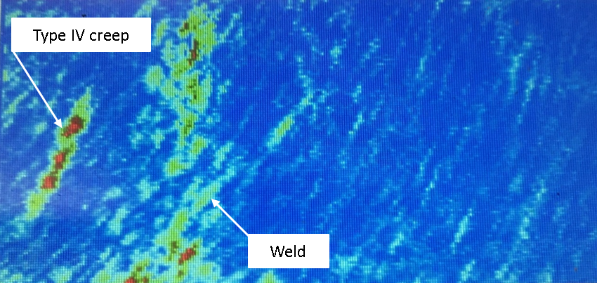

Ultrasonic testing B-scan display showing detection of Type IV micro-cracks using shear wave full matrix capture / total focusing method (FMC/TFM)
