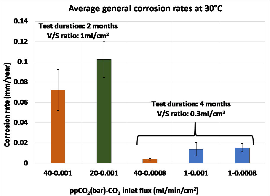

  • With respect to the effects of the experimental variables (temperature and CO2 partial partial pressure for same V/S ratio and CO2 inlet flow rate), the pH and corrosion rate are reduced for an increase in temperature and CO2 partial pressure.

Average general corrosion rates at different CO2 partial pressures and occlusion ratio, for same temperature
 1151-2021-Figure 2
