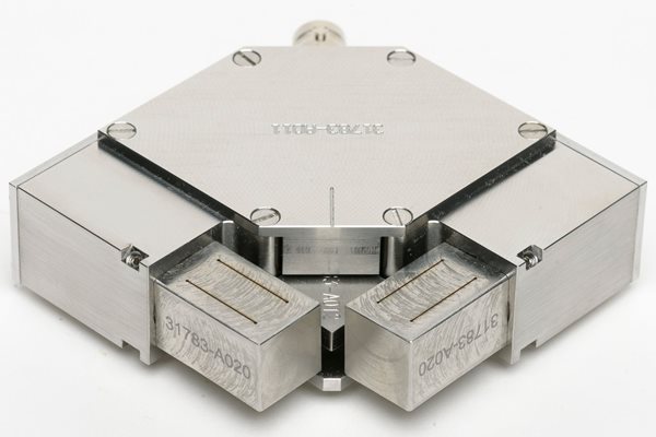

BeamAssure is a system of hardware and software that measures and presents a visual representation of the key characteristics of an electron beam system, ensuring that your electron beam welding processes are consistent – whether used on high value or high productivity production.
BeamAssure can either be integrated into an existing welding machine chamber and CNC/PLC or supplied as a portable option. Users can incorporate the system into a fully-automated production cycle or use it manually, as required.
Developed from decades of electron beam knowledge and development by TWI experts, BeamAssure displays results in real time, generating results that can be exported for analysis in a range of formats.
An easy-to-read traffic-light decision-making tool makes BeamAssure easy to use to determine beam focus settings without relying on operator or machine perception.
Capable of measuring low and high power beams as well as delivering long-term process quality assurance data without the need for thermal management or active cooling, BeamAssure will not intrude in your welding processes.
The durable and reliable system is already in use for production and research on three continents and has been instrumental in serial aero engine production since 2011.
With variants for welding, additive manufacturing and processing, BeamAssure is compatible with all welding machines (up to and in excess of 150kV), and capable of analysing beams at powers up to 100 kW.
