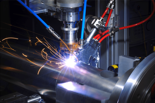

There are two fundamentally different modes of laser welding – conduction limited welding and keyhole welding. Each type differs according to the power density of the laser beam, with conduction welding having a density typically less than 105W/cm2. This means that the laser is only absorbed at the surface of the material without penetration. These type of welds typically show a high width-to-depth ratio.
Higher power densities are used for keyhole based laser welding, with the laser producing a power density that is typically > 106-107 W/cm2. This higher power means that the beam doesn’t just melt the material but actually vaporises it before significant amounts of heat can be removed through conduction. This focused laser beam penetrates into the workpiece, creating a cavity (or ‘keyhole’) that becomes filled with metal vapour that can sometimes ionise to form a plasma. The vapour or plasma helps prevent the molten walls of the cavity from collapsing. Meanwhile, surface tension causes some of the molten material at the leading edge of the keyhole to flow around the cavity to the back, where it solidifies to form the weld; creating a cap with a chevron pattern pointing backwards towards where the weld initiated.

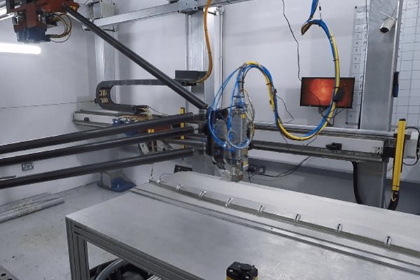

Laser welding is a versatile fusion welding process, which has found a number of applications in industry; from welding of car bodies and aircraft fuselage panels to the welding of shipbuilding structures down to joining components in medical devices.
The process can be used to weld a variety of materials including, carbon steels, stainless steels, titanium, aluminium and nickel alloys.
The industrial uptake of laser welding has been driven by requirements such as high volume production, high quality welds and/or low weld distortion.
