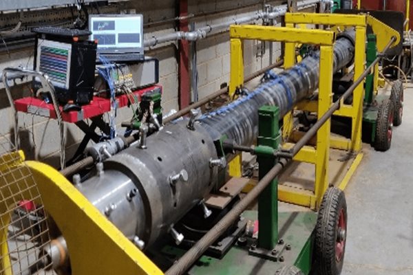

TWI has a dedicated group of highly skilled engineers who use state-of-the-art equipment – such as the Fluke Ti 30 portable thermal imaging camera, the LOT Oriel/Thermal wave imaging Inc system and acoustic emission testing equipment from M/s Physical Acoustics – to undertake a wide range of condition monitoring activities for our Industrial Members.
At TWI, we help companies and organisations manage the life of their structures to facilitate safe and efficient operation. Offering state-of-the-art condition monitoring solutions, we can deliver improved safety and reliability, reduced inspection and maintenance costs, and continuous monitoring processes.
Our approach uses permanently attached sensors, which collect data that enable the analysis of changes in performance or the condition of a machine or structure, providing real-time information on its condition. Technologies we use include acoustic emission, guided wave and vibration analysis.
The output is objective and provides reliable data showing any changes to the structure or component, from which an assessment can be made of the condition monitored asset’s overall present health as well as offering a tool for safely extending its useful life.
