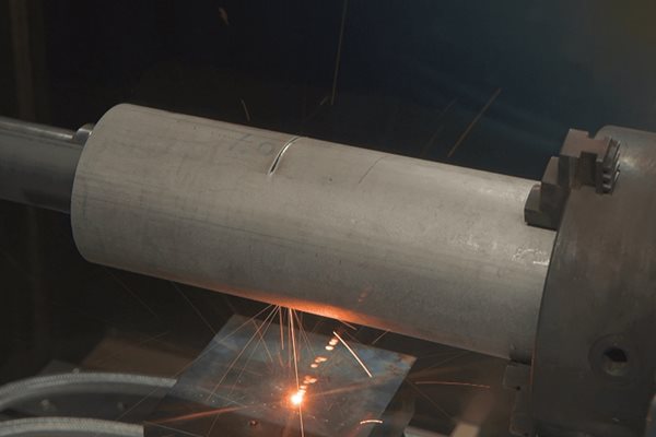

Electron beam welding (EBW) is a fusion welding process that uses a beam of high energy electrons to join metals. Typically performed in a vacuum chamber, the kinetic energy of the electrons create heat upon impact, melting the materials and creating a deep, narrow weld with minimal distortion and a narrow heat affected zone (HAZ). EB welding does not typically require the use of filler wire.
The process uses an electron gun to produce a stream of electrons, which are accelerated using a high voltage and then focused with magnetic lenses into a fine point of around 0.1mm in diameter. The electron beam is directed to where the workpieces are to be fused, melting the material with a ‘keyhole’ effect that can provide deep penetration into the parts. As the beam passes, often in a single pass, the molten metal solidifies and creates the weld. This technique achieves high welding speeds with great precision. Precise control of the power and focus allows for the penetration depth to be adjusted according to your requirements.
Electron beam (EB) welding needs to take place in a vacuum in order to prevent the electrons from being scattered by air molecules. The inert vacuum environment also leads to a cleaner final weld. This makes EB welding different from other ‘shielded’ welding processes, such as laser welding, which uses a focused beam and a shielding gas in the open air.
