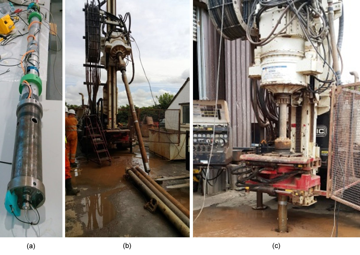

SOIMON prototype

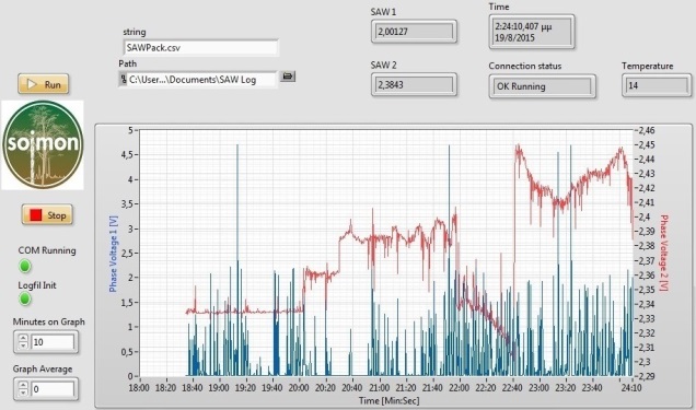

The SOIMON prototype (Figure 1) has been tested and validated on a contaminated site, where it was able to identify in real-time the VOC contamination in the terrain (Figure 2). During drilling the system withstood vibrations up to 80g and a shock of up to 120g, confirming the effectiveness of the anti-vibration system and the efficiency of structural health monitoring sensors throughout the drilling process.
Figure 1 (a) SOIMON Prototype; (b) SOIMON drill installation; (c) Sonic drilling with SOIMON.
Figure 2) SOIMON software VOC identification
