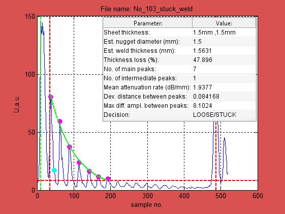

As part of the development work, the project team also created a set of samples to ensure that SpotTrackTM could reliably determine the quality of spot welds. Samples included good welds and a range of defective welds: undersized; stuck (where the zinc coating melts and sticks the two plates together but a proper bond is not achieved); oversized (burnt); and porous. The team used the data from these tests to develop novel signal processing algorithms for the inspection system.

Examples of spot weld macro sections and the decision made using the newly developed algorithm on specimens made with identical welding parameters: a) Undersized.
Examples of spot weld macro sections and the decision made using the newly developed algorithm on specimens made with identical welding parameters: a) Oversized/Burnt
Examples of spot weld macro sections and the decision made using the newly developed algorithm on specimens made with identical welding parameters: a) Undersized; 2- 2.5
a)
Examples of spot weld macro sections and the decision made using the newly developed algorithm on specimens made with identical welding parameters: a) Oversized/Burnt2.1 - 70
b)
Examples of spot weld macro sections and the decision made using the newly developed algorithm on specimens made with identical welding parameters; Loose/Stuck;
Examples of spot weld macro sections and the decision made using the newly developed algorithm on specimens made with identical welding parameters;Good.
Examples of spot weld macro sections and the decision made using the newly developed algorithm on specimens made with identical welding parameters; Loose/Stuck;2 - 3.99
c)
Examples of spot weld macro sections and the decision made using the newly developed algorithm on specimens made with identical welding parameters;Good 2-5-23.
d)
welding parameters:
  • a) Undersized;
  • b) Oversized/Burnt;
  • c) Loose/Stuck;
  • d) Good.
