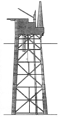

Fig.1. Magnus platform
When BP completed a difficult underwater repair in a closure weld at a water depth of 182m on its Magnus platform in the North Sea, TWI staff from several disciplines provided support on various technical aspects of the repair.

During routine inspection of the platform ( Fig 1) a flawed member ( Fig 2) was found to be flooded. Diver inspection revealed a through-thickness crack approximately 0.5m long in the circumferential weld connecting the diagonal brace to a leg node stub. BP's investigation of fabrication records showed the weld to have been repaired several times during construction because of root flaws. The weld was adjacent to an internal thickness transition - 45mm in the brace to 63.5mm in the stub ( Fig 3). A mechanical clamp was placed around the joint to bridge the crack, and to prevent relative movement of the two ends should the crack propagate further. At this stage, BP consulted TWI on a number of aspects of repair welding, heat treatment, NDT interpretation and possible causes of cracking.
