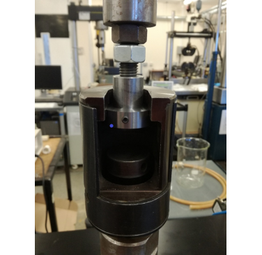

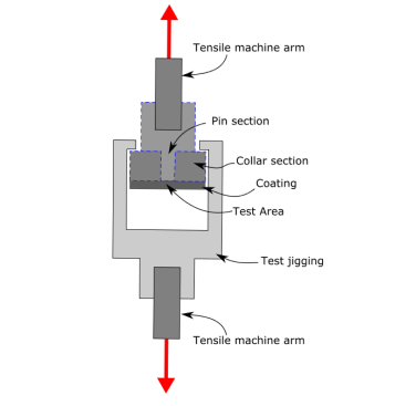

Coating adhesion tests typically used a stud attached to the coating surface with an adhesive before the bonded assembly is subjected to a controlled strain rate tensile test until the point of failure. However, advances in thermal and cold spray technology had resulted in coating bond strengths exceeding the maximum strength of available adhesives (70MPa). In order to measure the adhesion values of coatings with bond strengths in excess of 70MPa and order to validate their performance for load bearing applications it was necessary to develop and validate a bond strength test that didn’t require the use of an adhesive. To allow these higher bond strength coatings to be confidently used by industry, TWI delivered a 2020 project to develop and validate an adhesive-free bond strength test method for cold spray coatings (Figures 1-2).

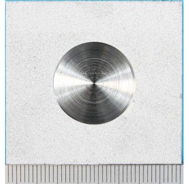

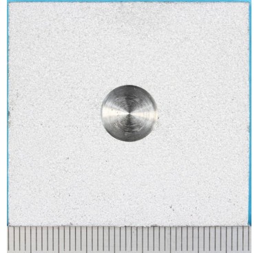

Thermally sprayed aluminium (TSA) coatings had been used to act as a barrier in all marine environments and offer cathodic protection to immersed steel structures in industries such as offshore wind. However, tests on the damage tolerance of these coatings had only been tested with single, small-scale damage such as scribes or holidays exposing up to 5% area of the specimen on the corrosion performance, and only for a limited time period. TWI recognised a need for information on the damage tolerance of thermal spray aluminium (TSA) coatings where a larger damaged area was used, over a longer term, and also taking account of any deposits on the defect regions to understand their role in the corrosion process and if they offer any protection Figures 3a, 3b and 3c show photographs of specimens before testing showing holiday (defect) size and distribution. Specimens were approximately 40mm×40mm with percentage defect areas of approximately 5% (a), and ~18% (b and c).

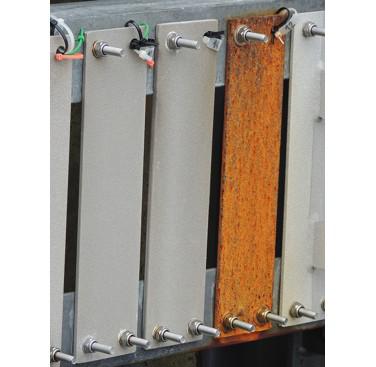

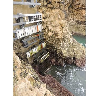

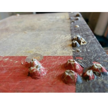

The ACORN project, funded by the European Commission, developed new advanced coatings to prevent marine biofouling on static offshore structures such as wind turbine towers and ocean energy generators as well as developing and proving a corrosion and cavitation resistant coating suitable for tidal energy generators (See figures 4-6). The CuVITO project produced a state-of-the-art copper nano-structured coating to provide antibacterial functionality and prevent leaching, and the WeldaPrime project addressed the corrosion of carbon steels used in the oil and gas, chemical, construction and marine industries. These steels were typically protected from corrosion during transportation and storage by zinc-based primers, but primers could cause problems with weldability and weld quality as well as health hazards. WeldaPrime aimed to develop a zinc-free primer with low organic content that could be applied at a low enough thickness to deliver weld-through capability without affecting weld quality and yet provide adequate corrosion protection.

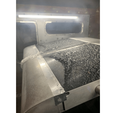

For the aerospace sector, the ICE-FREE and ICELIP projects (Figure 7) developed anti-ice coatings and COMPOCOAT created a new surface protection system for composite aero-engine aerofoil structures with a metallic leading edge. The C-JOINTS project used TWI’s dual experience in dissimilar materials joining and coatings technologies for composites to create composite joints for the aerospace industry with improved mechanical and electrical performance. With cross-over applications in the defence industry, the ENGPOW project aimed to advance UK industrial capability in relation to the use of cold spray technology to restore in-service wear/corrosion damage on high-value aluminium, magnesium and titanium aerospace parts through the development of specialised engineered powders.

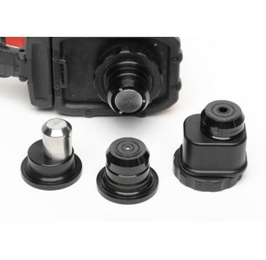

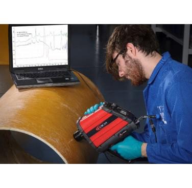

Our experts have also carried out hundreds of tests using Fourier transform infrared (FTIR) spectroscopy of downstream oil and gas component coatings. These tests ensured parts had been coated with specified materials to impart both corrosion resistance and appropriate surface characteristics. The inspection also ensured that there was no presence of a specific potential additive within the coating, which affects the mechanical function of these parts in service (Figures 10-11).

Figure 1. Loading of adhesive-free adhesion test specimen
Figure 2. Photograph of specimen in a tensile testing machine
Figure 3a. TSA coating damage tolerance defect specimen with approximately 5% defect area
Figure 3b. TSA coating damage tolerance defect specimen with approximately 18% defect area

Figure 4. ACORN project - barnacles settle on surfaces and breach through protective paint layers, causing extensive damage to the surface
Figure 5. ACORN project testing
Figure 6. ACORN project - left unprotected, steel rapidly corrodes in seawater. TSA provides local sacrificial protection and long-term corrosion protection
Figure 7. Aerospace icing (Courtesy of CAV-Advanced Technologies)

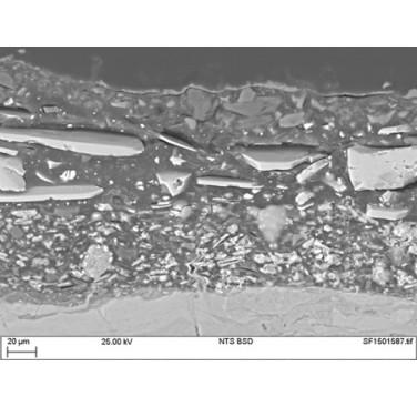

Figure 8. Backscattered SEM image of cross-sectioned specimen

Figure 10. FTIR instrument and different interchangeable objectives
Figure 11. The FTIR instrument in use

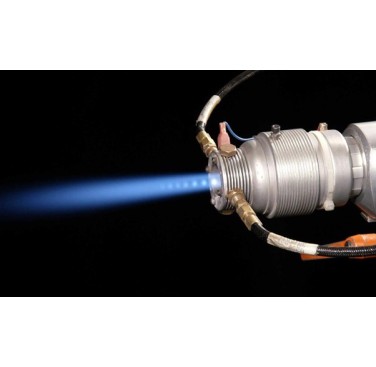

Figure 13. Thermal spraying
