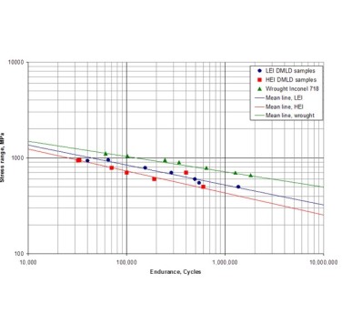

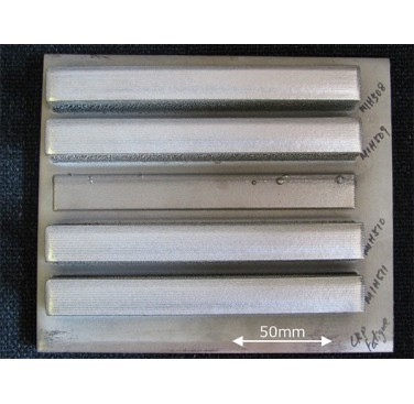

TWI’s earlier research into additive manufactured alloy 718 was extended with a further CRP project to provide mechanical performance data of LMD alloy 718. This would allow our team to optimise process parameters based on performance rather than metallurgical quality. Rectangular blocks of ally 718 were deposited on 316L stainless steel plates (Figure 1.) and subjected to direct two-stage heat treatment, with two parameters being developed for investigation; high energy input (HEI) and low energy input (LEI). Wrought alloy 718 was used as a benchmark for the LMD part tensile and fatigue testing (Figure 2), while creep rupture testing was also performed.

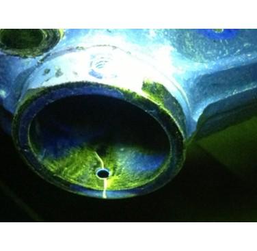

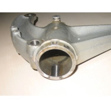

TWI was contacted by the Aircraft Restoration Company (ARC) who were restoring a Second World War Spitfire at Duxford Aerodrome in Cambridgeshire when a crack was detected in the landing gear suspension link. Our experts recommended high power LMD to deliver a crack free repair with a minimum effect on the properties of the original component material. The parameters for the repair were tested on a scrap part provided by ARC. Because the material grade used for the original Spitfire manufacture was now obsolete, we identified a modern high tensile steel that was available as a metal powder and closely matched the original for composition and material properties. Following an NDT inspection of the defect to determine the extent of the cracking, the defective material was machined away, allowing us to deliver a crack free repair of the landing gear component (Figures 3-5).

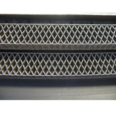

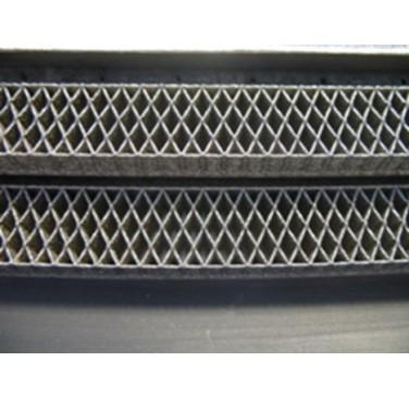

TWI worked alongside a leading aircraft engine manufacturer to develop direct metal laser deposition (DMLD) for the repair of blades and seal segments (Figure 6).

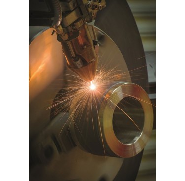

We were contacted by an Industrial Member company to conduct a programme of work to apply LMD to both new and worn shafts from industrial rotating equipment. Having assessed the repair requirements and determined that LMD was the best solution to the challenge, TWI produced cladded test pieces for analysis using an agreed deposit geometry. One shaft was supplied specifically for experimenting with process parameters, which allowed us to produce a welding procedure specification for the client’s approval. This specification was then used for the repair of the two worn shafts (Figure 7).

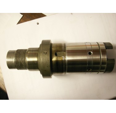

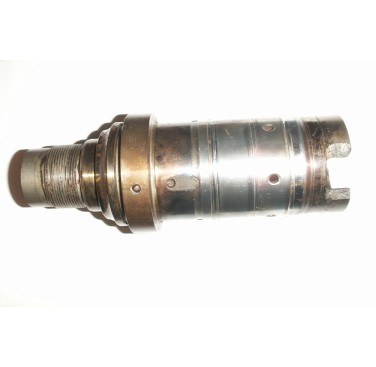

Rotherham-based SME, Hydraulic Pumps (UK) Ltd contacted TWI to solve a challenge related to the repair of hydraulic units. Due to the aggressive operating conditions in which they operate, parts typically suffer from severe wear and damage. However, some of the components are either obsolete or have high costs and lead times for replacements. We were able to recommend LMD as a potential solution, allowing parts that would have been scrapped to be repaired and returned to service. The low heat nature of LMD means that the material properties of the highly alloyed carbon steels used for hydraulic pump components are unaffected by the process, completing the repair without affecting the strength of the part and without the likelihood of significant distortion. The process was tested on damaged pump shafts (Figure 8) that were repaired using LMD (Figure 9) and returned to Hydraulic Pumps (UK) Ltd where the deposited material was machined back to original size and tolerance and the repaired parts were fitted back into their original casings and subjected to a range of tests before being dispatched to customers for extended use.

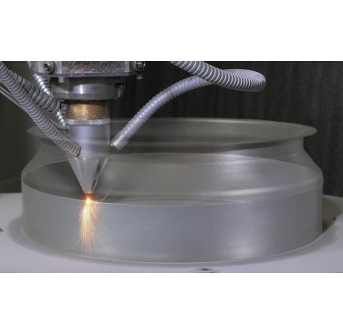

TWI was originally invited to display a helicopter combustion chamber casing made through LMD (Figure 10). However, our experts decided to build something more befitting an art exhibition and so created a Rubin vase that was quite possibly one of the largest thin-walled net shape components built by LMD at the time, standing nearly 400mm tall with a consistent wall thickness of 0.9mm. The design was modelled on the facial profile of Alfred Hitchcock and the LMD process used was an approach developed by TWI, where the precise synchronisation of the movements of rotation and tilt of the substrate with incremental movements of the coaxial nozzle (predominantly in the +Z direction) allows a continuous spiralling weld track to be deposited or ‘grown’, layer on layer, out of the substrate. This helical multi-layering technique allows a thin-walled 3D contour to form which accurately follows the specification of the original CAD surface profile. To improve the aesthetics of the vase for the purpose of the exhibition, the external surface was lightly shot blasted, primarily to remove excess powder, and the internal surface of the bowl was polished (Figure 11).

Figure 1. Test samples produced using HEI parameters
Figure 2. Fatigue test results
Figure 3. NDT image showing extent of crack on aircraft undercarriage component
Figure 4. Completed repair after deposition and machining away of internal sleeve

Figure 6. Aeroengine LMD part repair
Figure 7. LMD shaft repair
Figure 8. Damaged hydraulic pump shaft
Figure 9. Finished repaired shaft
Figure 10. Five-axis manufacture of the helicopter engine combustion casing
