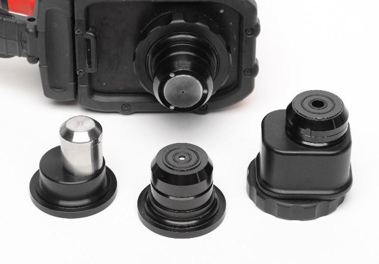

The inspection is carried out using a portable FTIR instrument from Agilent (Exoscan 4100), which has a number of interchangeable objectives to accommodate different forms and shapes of the material to be analysed. The objectives comprise:
  • Diamond ATR (flat surface) – good for liquids and soft solids
  • Diamond ATR (curved surface) – good for harder materials and films
  • Specular reflectance – good for smooth reflective surfaces
  • Diffuse reflectance – good for rough irregular surfaces
Figure 1: FTIR Instrument and different interchangeable objectives

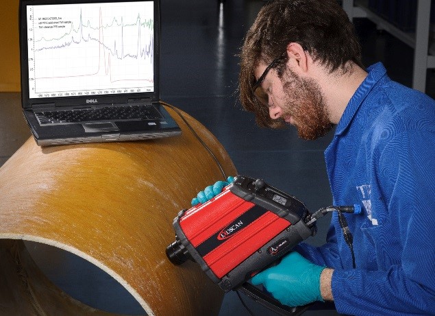

The process is quick (~15 seconds per spectrum), non-destructive and non-intrusive, which is ideal for a number of development and safety critical applications where coatings or layers of surface material cannot be removed from the part to be analysed. Indeed, in the case of the diffuse reflectance objective, the assessment can be completely non-contact, with the sample surface around 10mm away from the instrument.

The portable nature of the instrument means that trained TWI staff can carry out FTIR analysis both off-site and in the laboratory. Subsequent analysis of the data can be carried out off-line by the appropriate expert within the company. Once the spectra have been acquired, TWI has access to a large spectral database to ensure accurate and rapid material identification. In some instances further analysis may need to be carried out using TWI’s benchtop FTIR microscope (spot size ~20microns) and Scanning Electron Microscope (SEM). This combination, along with other analytical capabilities, makes the FTIR instrument an indispensable tool in the area of acceptance test, material characterisation and failure investigation for clients at any location.

Figure 2: The FTIR instrument in use
