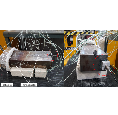

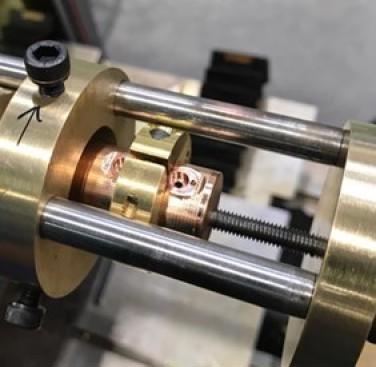

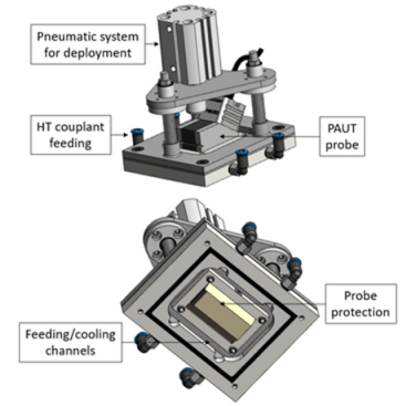

Combining our work with local chamber EB welding with efforts to monitor the process in real time, we created a 2020 CRP project aimed at using ultrasonic testing (UT) to monitor the reduced pressure electron beam welding (RPEBW) process, including the design of a phased array ultrasonic testing (PAUT) prototype system for real-time monitoring of RPEBW in process conditions (Figures 1-3). This core research continued into 2025, with work to correlate between data collected during welding and flaws that are likely to appear in the joints.

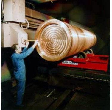

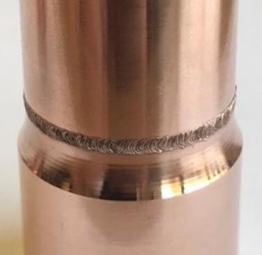

TWI provided expertise and process guidance for nuclear waste management programmes across the world, determining that electron beam welding was a reliable process for the manufacture of spent nuclear fuel containers. This work began in the late 1980s and early 1990s, with later R&D establishing best practice for materials selection as well as setting down a series of manufacturing and high integrity welding methods and parameters for fabricating and sealing containers (Figure 15).

Figure 2. Experimental measurement of ultrasound velocity and attenuation. The steel block is heated at one end by a heating pad, with thermocouples used to log the temperature. The dotted red circle shows the ultrasonic probe
Figure 3. Prototype designed for EBW monitoring tool

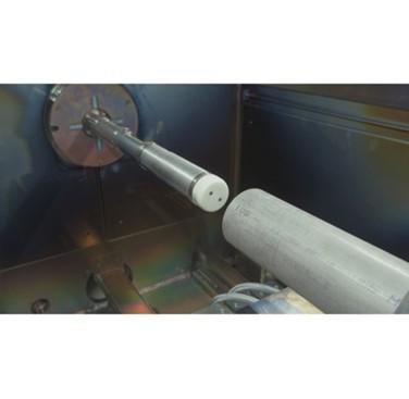

Figure 4. EBOBend equipment inside the EB vacuum chamber

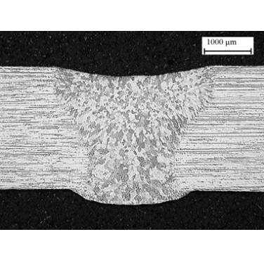

Figure 5. Transverse weld macro of the inside out welded Duplex pipe

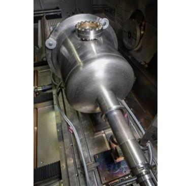

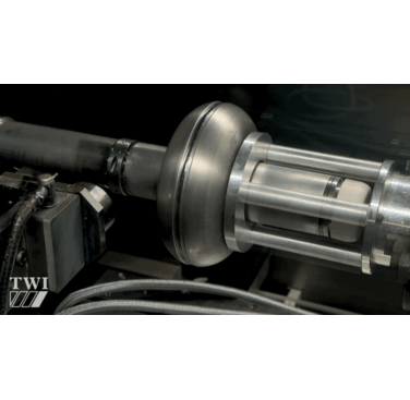

Figure 6. Weld repair simulation set-up for single SRF cavity

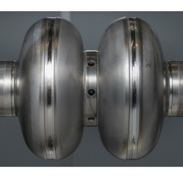

Figure 9. Electron beam welded twin cell demonstration SRF cavity

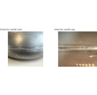

Figure 10a / 10b. Exterior weld root / Interior weld cap

Figure 15. Prototype copper canister developed at TWI for the Swedish Nuclear Fuel and Waste Management Co (SKB)

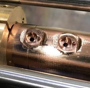

Figure 18. Complex sensor geometry locations
Figure 19. Complex sensor geometry locations
