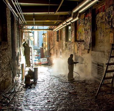

Current anti-graffiti measures fall into two categories; sacrificial and permanent.
Sacrificial coatings, while offering a cheap solution, incur long-term labour costs for the periodic removal and re-application of the coating to ensure peak performance.
Permanent coatings also include long-term cleaning costs as well as the requirement to use removal solutions. These solutions are often made from environmentally damaging chemicals that are hazardous to health.
Most of the current anti-graffiti measures do not have the desired hydrophobic and oleophobic properties required for total protection. Existing anti-graffiti solutions also have questions related to durability.
These factors all create an opportunity and need to improve on current anti-graffiti coatings to deliver a more cost-effective, durable and green solution.
