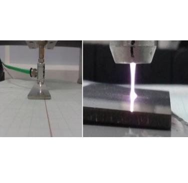

- Plasma Treatment for Bonding of Aerospace Components
Outside of welding, we have also investigated developments to adhesive bonding of composites with a research project to explore the potential of using plasma treatment on the surface of composite aerospace components before they are adhesively bonded. This work aimed to improve the repair and lifetime extension of airframes through the use of adhesively bonded composite patches that have undergone plasma treatment to the surface (Figure 4) as an alternative energetic technique. This method sidesteps many of the disadvantages of the existing pre-treatments, such as debris, environmental issues and health and safety concerns. The plasma surface treatment was compared to both abrasion and grit blasting surface treatment techniques. The study considered treatment distance, dwell time, the number of passes required and the gas flow rate. Around 200 joints were manufactured and tested to identify the best treatment conditions.

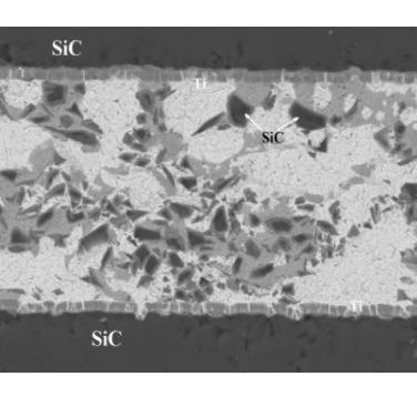

- Ceramic Matrix Composites – Joining to Metals
Ceramic matrix composites, such as SiC/SiC and C/SiC, are lightweight, hard, wear resistant and stable in oxidising environments to temperatures as high as 1600°C. Because of their fibre reinforcement, they have improved mechanical properties, failing in a gradual rather than catastrophic mode. They are particularly suitable for applications in high temperature burner environments where they can outperform more conventional superalloys.
Many high temperature applications using ceramic matrix composites require them to be joined to other materials, including metals. Brazing is a highly effective joining technique for many ceramic-ceramic and ceramic-metal joint systems. However, differences in coefficients of thermal expansion require specialised approaches to accommodate the mechanical stresses introduced by joining. This can be achieved, for example by flexible or ductile interlayers, or by careful selection of interlayers expansion matched to the ceramic. Additionally, non-melting materials, such as ceramic particles, can be dispersed in the braze to adjust its thermal expansion coefficient or ductility (Figure 6). Design of such joints, using techniques such as finite element modelling, is also of critical importance to minimise stresses.

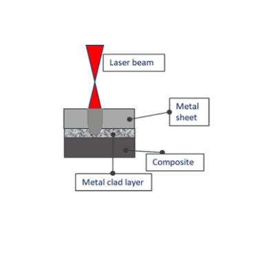

- Laser Riveting for Composite-to-Metal Joining
Our experts investigated the use of laser riveting to join composites to metals. The aim of the project was to design and produce composite / metal assemblies with an interface region that acts as a ‘transition zone’ tailored to each application and geometry. This would allow industries such as automotive and aerospace to take advantage of the high specific strength and stiffness, energy absorption, high bearing load resistance, as well as the corrosion and fatigue resistance, and typically lower costs offered by composites. The use of laser riveting was researched to avoid the drawbacks associated with traditional mechanical fastening (additional weight) and adhesives (durability issues).
The concept of the work was to join a composite to a metal using a metal rivet, improving the fundamental empirical understanding of key variables and their influence on a joint’s properties. The solution was also designed to allow for higher productivity. Figure 7 shows the technical concept of the laser riveting solution we developed.

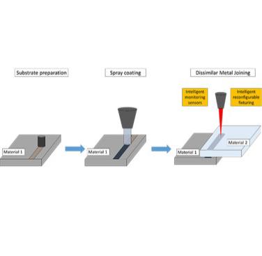

- Ultimate Project to Develop Dissimilar Joining for Industry
The Ultimate project also investigated solutions for dissimilar materials joining through the development of a fusion welding solution to join dissimilar metals and also metals to composites. Initially developed at laboratory scale, the solution was then validated through relevant case studies indicated by the end users. The overall objectives were to develop laser welding solutions for joining composite to metal parts in an overlap joint configuration. This approach can be exploited over different joining configurations (Figure 8-10). The Ultimate Project also included the integration and validation of intelligent fixturing and on-line quality assurance (QA), capable of performing real-time monitoring of weld depths during processing.

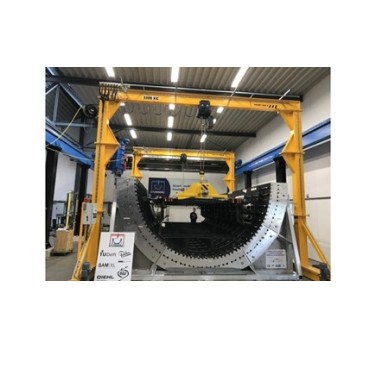

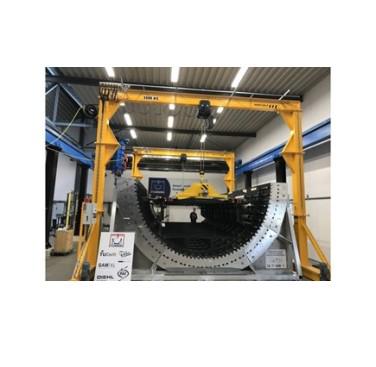

- TCTool: Developing Large-Scale Thermoplastic Aerostructures
Also using thermoplastics for aerospace, but on a much larger scale was the TCTool project. This project saw our experts deliver one of the largest thermoplastic aerostructures in the world. Working alongside a group of project partners, we helped develop innovative tooling, end effectors and industrialisation for the welding and assembly of thermoplastic fuselage components. This involved new approaches to tooling and automation to lower or remove fixed tooling costs that could account for over one-third of non-recurring aircraft assembly costs.
As well as reducing costs, the use of thermoplastic composites in aircraft aids light-weighting as being able to weld them together removes the need for thousands of weight-increasing fasteners.
The 8 metre by 4 metre multi-functional fuselage demonstrator (MFFD) includes over 400 thermoplastic fibre-reinforced parts, thousands of spot welds and hundreds of metres of continuous welds, demonstrating the feasibility of high-rate production, while also delivering a promised 10% reduction in fuselage weight and a 20% reduction in recurring costs (Figure 13).

Figure 4. Plasma treatment equipment

Figure 6. Cross-section of a ceramic-reinforced brazed joint in silicon carbide; brazed with Cu-Ag-Ti-10%SiC
Figure 7. Laser riveting technical concept
Figure 8. Ultimate general concept for composite to metal joining

Figure 13. TCTool fuselage demonstrator
