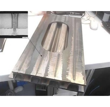

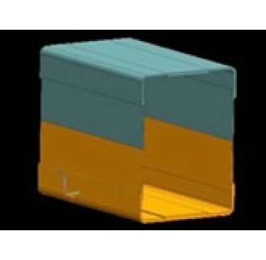

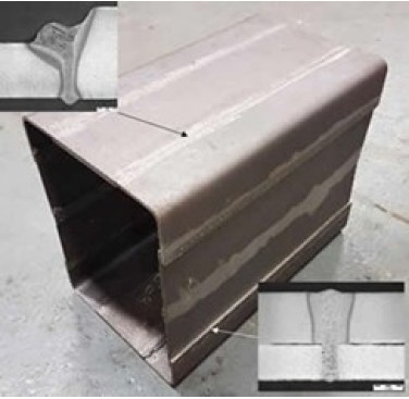

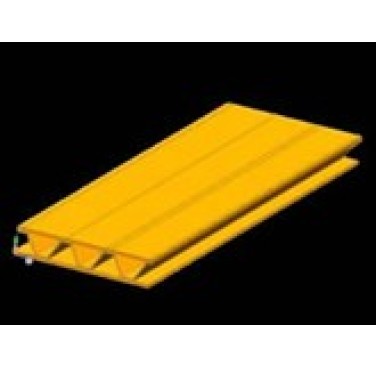

TWI also worked on the Innovate UK-funded ELSOHA project alongside JCB and Tata Steel, which aimed to develop new designs and associated manufacturing methods for lighter-weight, next generation, off-highway vehicles. The project team investigated alternatives manufacturing processes to the existing arc welding solutions, including laser welding, hybrid laser-arc welding, rotary friction welding and adhesive bonding. Sandwich panels and tailored blanks were chosen as solutions to reduce weight without compromising performance. TWI conducted welding trials to develop suitable processes, parameters and fixtures for laser stake welding and hybrid laser-arc butt welding of the demonstrator panels and tailored sections, using novel, higher performance steels from Tata Steel (Figures 1-5).

Figure 2. Sandwich panel
Figure 3. Tailored Blank
Figure 4. Laser stake welded sandwich panel with (inset) typical cross-section
Figure 5. Laser welded tailored blank
