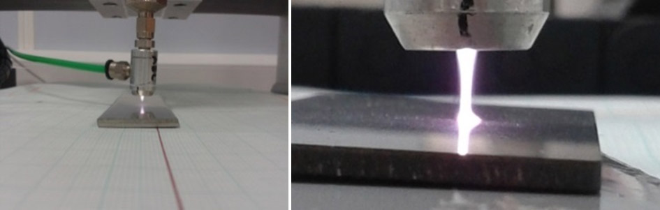

This research will evaluate plasma treatment (Figure 1) as an alternative energetic technique. This method sidesteps many of the disadvantages of current pre-treatments, such as debris, environmental issues and health and safety concerns.

Figure 1 Plasma treatment equipment

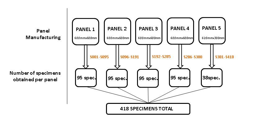

Around 200 joints will be manufactured and tested as shown in the test matrix in Figure 2.

Testing will identify the best treatment conditions to be selected for the next phase. Specimens will be bonded and tested through mechanical test (BS ISO 4587 ‘Determination of tensile lap-shear strength of rigid-to-rigid bonded assemblies’)

Figure 2 Panel manufacturing and specimens
