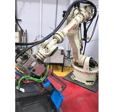

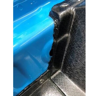

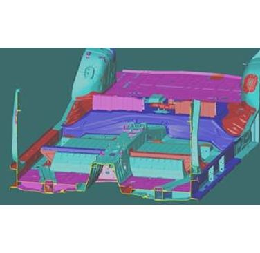

TWI investigated techniques to insert carbon fibre floors into Nissan cars, with two specific methods being explored. The first method involved adding the floor after the car body was made by using blind riveting to join the two different materials together using a cold curing polyurethane adhesive. The second method consisted of integrating the floor at the same time as the making of the body, through punching in a steel element before direct resistance spot welding.
