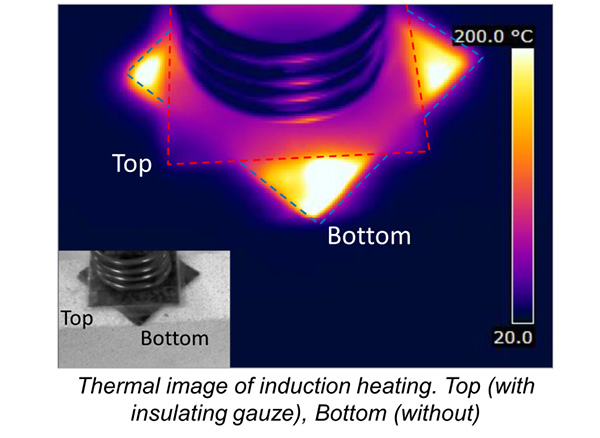

Figure 1 Thermal image of induction heating with insulating gauze (top) and without (bottom)

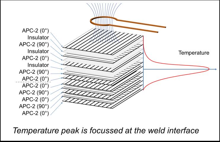

To demonstrate the focused heating effect, two  laminates were manufactured, each containing carbon/PEEK (APC-2) plies at 0/90 orientation, manufactured using TWI’s novel technique, so that when placed together, heating would be concentrated at the interface between the two laminates. The two laminates were then offset by 45 degrees to allow measurement of the surface temperature of the lower laminate using a thermal image camera. A 1kW induction power supply was used to apply an alternating electromagnetic field through a solenoid coil at a frequency of 165kHz for a period of 60 seconds.
Results of the temperature rise (Figure 1) show that despite being closer to the source of the electromagnetic radiation, the top laminate experienced a much smaller temperature rise compared to the bottom laminate. The heating has therefore been focused at the interface between the two laminates.

Figure 2 Temperature peak is focused at the weld interface
