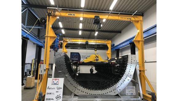

This work has led to the creation of a thermoplastic fuselage demonstrator, using thermoplastic composite technologies and smart robotics that promises a reduction in weight and manufacturing costs for aircraft.
The 8 metre by 4 metre multi-functional fuselage demonstrator (MFFD), which was delivered by the Clean Sky 2 STUNNING project, acts as the lower half of the overall fuselage demonstrator.
The structure includes over 400 thermoplastic fibre-reinforced parts, thousands of spot welds and hundreds of metres of continuous welds, demonstrating the feasibility of high rate production of between 60 and 100 aircraft per month. This development also promises a 10% reduction in fuselage weight and a 20% reduction in recurring costs.
