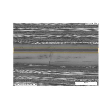

Then a CFRTPC laminate was manufactured to suit these parameters and a small series of three joints was produced. Figure 1 shows a fully bonded interlayer.

Figure 1. Sacrificial PEEK interlayer between two carbon/PEEK laminates. Yellow lines denote weld location
