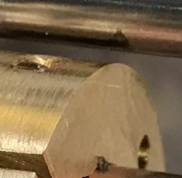

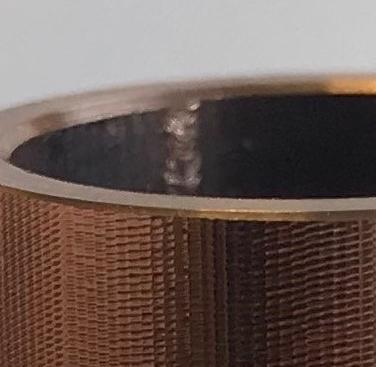

Cu-Be test piece welds
Work Programme
The weld development programme focussed on producing welds in the required orientation (1G), and used simplified test pieces of the probe body and sensors. Test pieces used variable thickness longitudinal joints, circumferential joints, and welds in representative geometries of small scale non-concentric nested planetary parts.

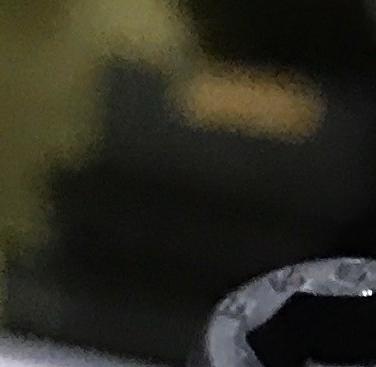

The prototype component was assembled in a bespoke fixture designed and manufactured by CA with input from TWI. The fixture required careful design to accommodate the sensor tubes and additional thermocouple wiring. The assembled unit was secured in TWI’s 4kW 60kV electron beam welding facility which has full cnc control of all major axes (mechanical and electrical) and is fitted with TWI’s digital multi-axis beam deflection system. High definition CCTV fitted to the telescope optics was used to accurately locate the joints to a tolerance of +/-20µm.
The final welding plan was a complex multistage approach, in some cases using a two stage overlapping method to control heat-input and realise high quality welds. The complex geometry of the sensor components required welding paths defined by TWI’s deflection system. After successfully completing the welding plan, the probe was subjected to extended testing at CA and has produced promising results leading to further work on additional prototypes.

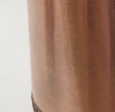

Complex sensor geometry locations
