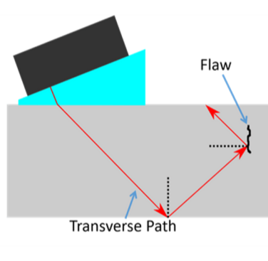

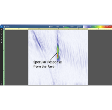

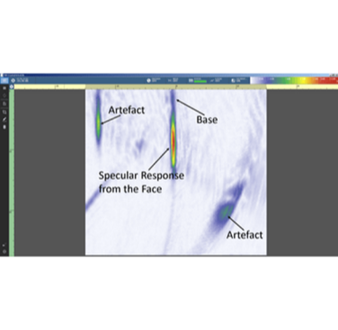

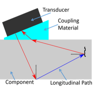

- Multimode Virtual Source Aperture Imaging for Non-Destructive Testing
Virtual source aperture (VSA) is a supplementary technique for FMC that was developed at TWI to improve imaging rates by combining phased array-like transmission with FMC reception, improving the A-scan signal to noise ratio (SNR) and reducing the number of transmissions required. This project worked to develop a VSA multi-mode imaging algorithm and find a computationally efficient approach to solving Fermat’s principle of least time for multiple refractive boundaries. Single mode signals were typically preferred to weaker mode-converted signals, however it can be beneficial to analyse them as shown in figures 1a and 1b, which demonstrate how a multimode sound path is more likely to return to the transducer to be detected. This project created an approach that reduced the path calculation by a factor of two, thereby increasing frame rates for inspection. The effect of this approach for improving flaw characterisation and sizing accuracy can be seen in figures 2a and 2b.

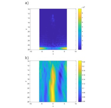

- Advanced Ultrasonic Imaging Techniques for Aerospace Components
This project worked for the benefit of the aerospace industry by assessing FMC-based ultrasonic testing techniques developed at the University of Bristol. This allowed us to provide objective technical information on the potential industry use of the processing techniques and their likely benefit to industry (Figures 3-4).

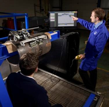

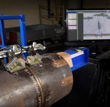

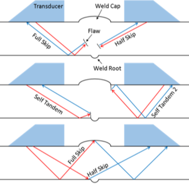

- Fast Fully Focussed Ultrasonic Inspection of Girth Welds
Millions of miles of pipeline rely on pipeline girth weld inspection to maintain their integrity and ensure the continuous flow of resources from production sites to users. Ultrasonic testing has played a vital role in this for decades, but advances in algorithms to interpret data have simplified the inspection process and allowed users to view the data in ways not considered before, improving the way in which flaws can be detected and sized, while also increasing the variety of flaw types that can be found. Real-time total focussing method (TFM) based algorithms, such as FMC, VSA and PWI, process the ultrasonic data to synthesise a PA focal spot at every pixel in an image, giving a fully focussed, easily interpreted image. The CrystalTM software provided TFM-based, fully focussed ultrasonic imaging capable of many different imaging views that are specifically designed for a certain type of flaw, in a certain part of the weld, and at a certain orientation. The software allowed for a coordinated inspection with two transducers, each displaying a half skip, full skip and self-tandem channels, along with a half skip and full skip pitch-catch channel. These imaging views can be combined into a single image by using known reflectors for calibration. Each view was designed to highlight a specific flaw type and orientation. By combining the imaging views, the Crystal software provides the highest probability of detecting and sizing a wide variety of flaws that can occur within a girth weld (Figures 5-7). You can find out more about TWI CrystalTM here.

Figure 1a. Depiction of sound paths for multimode
Figure 1b. Depiction of sound paths for single mode inspection
Figure 2a. VSA image of a surface breaking flaw using self-tandem using single mode. Here only the lower part of the flaw can be detected
Figure 2b. VSA image of a surface breaking flaw using the self-tandem multimode method. Here the base of the flaw can be distinguished

Figure 4. Image of the fatigue crack using (a) FMC, (b) the nonlinear technique

Figure 5. Full matrix capture inspection of a pipeline girth weld sample using TWI’s Crystal testing software. Half skip, full skip and self-tandem modes considered, along with a pitch catch channel
Figure 6. Image depicting the half skip and full skip views (top), the self-tandem views (middle), and the pitch catch half skip and full skip channels (bottom)
Figure 7. Full Matrix Capture inspection of a pipeline girth weld sample using TWI’s Crystal testing software
