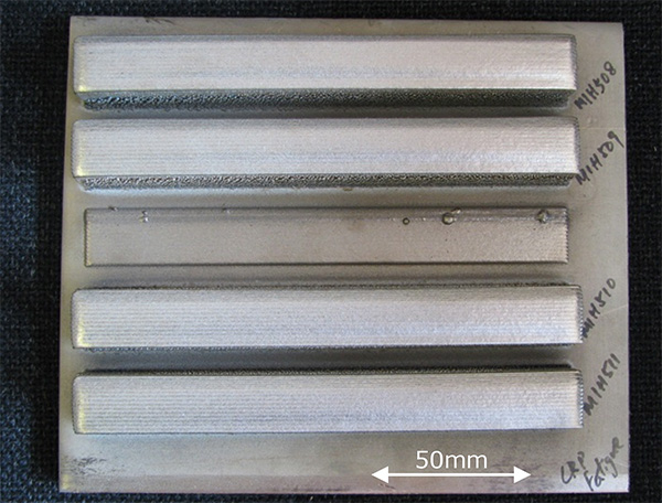

Rectangular blocks of alloy 718 were deposited on 316L stainless steel plates using a Huffman HC-205 laser cladding machine (Fig. 1). Samples were subjected to a direct two-stage heat treatment.
Following process optimisation, two parameters were developed for investigation: high energy input (HEI) and low energy input (LEI).
Wrought alloy 718 was also used to provide a benchmark for tensile and fatigue testing. The material was solution heat treated at 980°C before being subjected to the same two-stage ageing process used for the LMD samples.
Fig. 1 Test samples produced using HEI parameters

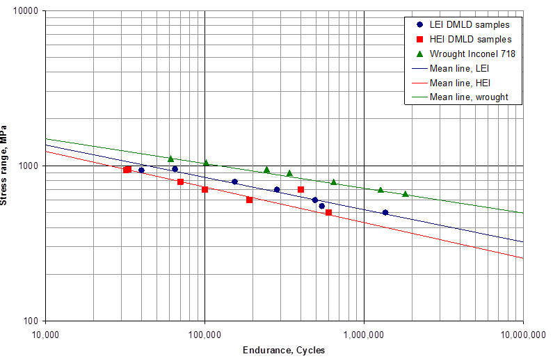

Fatigue endurance data, plotted in the form of an S-N diagram, showed that LEI samples gave a better fatigue performance than HEI with average lives 2x105 to 4.5x105 cycles greater for a given stress range.
A mean line through each test series was compared at 106 cycles. Wrought material gave the highest fatigue strength at 720MPa followed by LEI (525MPa) and HEI (435MPa) (Fig. 2).
The reduction in tensile and fatigue performance as compared to the fully aged wrought material may be due to over-ageing in the deposits due to multiple thermal cycles during deposition, prior to the double ageing post-weld heat treatment.
Creep rupture testing found that the performance of LEI samples was comparable with published data for alloy 718 aged at 649°C. HEI samples gave a slightly higher rupture life by a factor of 1.62 on endurance (hrs) at a stress of 690MPa.
The slightly better creep rupture performance of HEI samples was probably due to a coarser grain structure.
