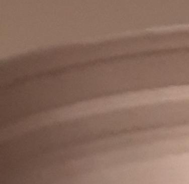

The finished vase modelled on the facial profile of Alfred Hitchcock

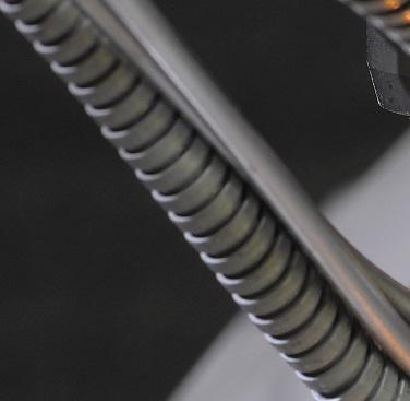

In LMD, a weld track is formed using metal powder as a filler material which is fed, through a coaxial nozzle, to a melt pool created by a focused high-power laser beam. Using an approach developed by TWI, the precise synchronisation of the movements of rotation and tilt of the substrate with incremental movements of the coaxial nozzle (predominantly in the +Z direction) allows a continuous spiralling weld track to be deposited or ‘grown’, layer on layer, out of the substrate.
This helical multi-layering technique allows a thin-walled 3D contour to form which accurately follows the specification of the original CAD surface profile.

The vase was built in a single stage using Inconel 718 powder: a consistent track weld of width 0.9mm, depth 0.2mm and a total length of nearly 1.8km, covering 2400 rotations in a 26-hour build time. Four kilograms of powder was used and 3.2kg was fused in the vase, giving 80% powder efficiency. The vase stands nearly 400mm tall with a maximum diameter of 380mm. To improve the aesthetics of the vase for the purpose of the exhibition, the external surface was lightly shot blasted, primarily to remove excess powder, and the internal surface of the bowl was polished.
Laser metal deposition (LMD) process
