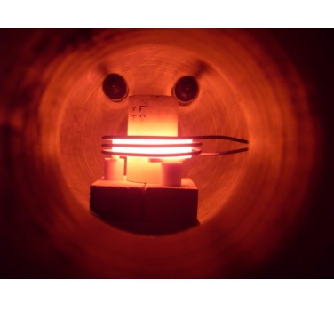

ANDRA are the French national radioactive waste management agency, responsible for the long-term management of radioactive waste produced in France. They were seeking a solution for the long term disposal of waste through encapsulation in ceramic overpacks.
Aluminosilicate ceramics were identified as a potential option, with the right properties to enclose waste encapsulation canisters. However, to use them it was necessary to find a way to hermetically seal the lid to the body of the canister without damaging the vitrified radioactive waste inside. The challenge being that the safe limit on the inner temperature was 600°C whilst the ceramic diffusion bonding temperature is around 1150°C.
TWI offered a solution by showing that radiant heating could be used to diffusion bond aluminosilicate ceramic components (Figure 1). Following trials that saw an induction heating system installed at TWI, a proof of concept report was sent to the client, detailing the relevant parameters and associated results and conclusions.

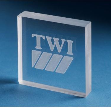

On a far smaller scale, TWI also drew upon over 50 years of diffusion bonding experience to create micro channels in polymers…

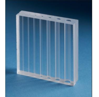

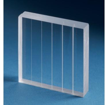

- Diffusion Bonding of Micro-Channelled Polymers
Micro-fluidic channels are used on industries including diagnostic, medical, pharmaceutical and aerospace, where they are used to precisely deliver small quantities of fluid. Where thermal bonding has been used in the past, our experts opted for diffusion bonding as a cost-effective, clean and safe alternative with the addition of laser machining to create channels of between 5mm and 50 microns in size. The polymers were heated in a vacuum furnace to below the glass transition temperature before the channels were checked under an optical microscope and pressure tested to assess their effectiveness. The process used to bond the thermoplastics retained the optical transparency of the part with no deformation or polymer shrinkage of the channels after diffusion bonding. The joint was completely autogenous, with no visible bond line or leaks, which will avoid fungal growth while also maintaining precise flow control. Our results showed that, with the recent advancement in technology and industries looking for clean and sustainable processes, diffusion bonding with laser channelling can prove to be one of the potential candidates for manufacturing the next generation of microfluidic devices.

Figure 1. Radiant diffusion bonding

Figure 3. Diffusion bonded PMMA with laser processed channels
Figure 4.  Diffusion bonded PC with precision machined channels
