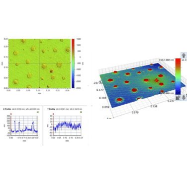

Optical techniques include white light interferometry, confocal microscopy and high-speed areal mapping. White light interferometry (WLI), is a non-contact technique, which provides quantitative surface topography information from all surfaces, see Figure 1. Surface metrology data is presented in the form of pseudo-colour height maps, 3D images, line profiles and surface roughness parameters, see Figure 2. Surface roughness is quantified by measuring the interference pattern of split light beams while scanning the surface of the test piece. Confocal microscopy is also a non-contact technique that can be used to measure the shape and surface finish on micro-structured surfaces providing a 3D surface profile, see Figure 3. Both these techniques capture depth information, and can provide colour contoured maps of surfaces.

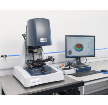

Figure 1: TWI’s Bruker Contour GT white light interferometer
Figure 2: Output of the Bruker Contour GT white light interferometer showing 2D profile with colour roughness scale and X,Y line profiles (left), and 3D topography with colour roughness scale

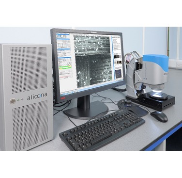

Figure 3: TWI’s Alicona Infinite Focus SL optical 3D confocal microscope
