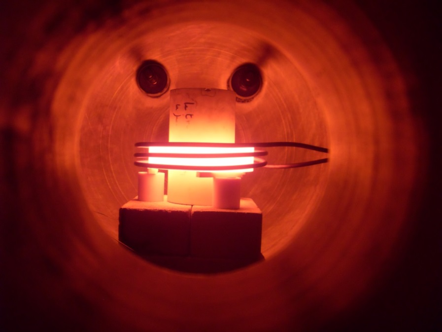

Radiant heating was successfully used to prove that aluminosilicate ceramic components could be diffusion bonded. TWI’s vacuum furnaces were adapted to install an induction heating system. Diffusion bonding trials were performed under vacuum with a back fill of Argon for safety reasons, linked to the use of a graphite susceptor. This technique showed efficiency in heating a controlled area at the joint, demonstrating proof of principle to the client.
