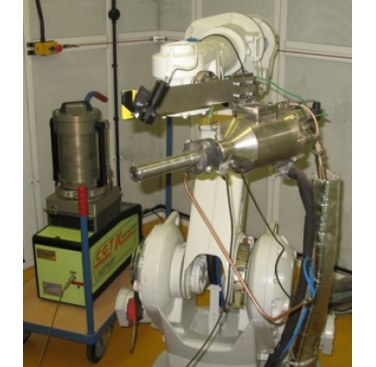

- Coaxially Laser Assisted Cold Spray (Additive Manufacturing)
The European Commission-funded COLA project investigated the use of cold spray for aeroengine maintenance, repair and overhaul. With many airlines now leasing engines the responsibility for maintaining them falls to manufacturers and their suppliers, not just during production, but throughout their service life.

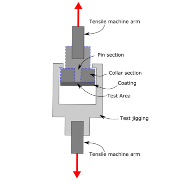

- Adhesive-Free Bond Strength Test Method for Cold Spray Coatings
Cold spray technology advances allowed for increased coating bond strengths that matched the maximum strength of available adhesives (70MPa). TWI tested these bond strengths to ascertain the true bond strengths of both high velocity oxygen fuel (HVOF) and cold spray deposits that can be in excess of 150 MPa. This work validated the adhesive-free adhesion test for assessing coatings with bond strengths over 90 MPa (Figures 1-2).

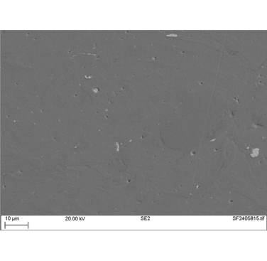

- Cold Spray Deposition of a Powder Produced from a Beta Titanium Alloy
As cold spray repair continued to advance as a method for repairing titanium alloys there were still challenges around achieving sufficiently dense, well-bonded coatings using a cost-effective process gas such as nitrogen. Although most repairs aim to use a deposit with the same composition as the substrate, high density materials require the powder particles to sufficiently deform to prevent the formation of pores. For example, with titanium alloys such as Ti-6Al-4V, it is thought that the powders produced from conventional gas atomisation have limited ductility due to their microstructure of primarily of hexagonal close packed alpha. As such, TWI investigated depositing alternative titanium alloys with greater ductility as a route to higher performance deposits, despite issues surrounding depositing a dissimilar metal combination (Figures 3-4).

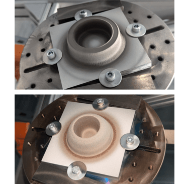

- Cold Spray Evaluation Programme Success with Ansaldo Energia
Our experts collaborated with Italian power engineering company Ansaldo Energia to conduct some experiments with cold spray on discs to create a coating thickness of ~250µm in four passes. Following the spray deposition, the disc samples were diffusion heat treated. The cold sprayed parts showed smoother surface morphology and less coating degradation than with alternative coating methods (Figure 5).

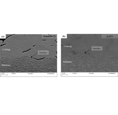

Continuing our research into the use of cold spray led to the publication of the research article, ‘Understanding the effect of substrate preheating temperature and track spacing on laser assisted cold spraying of Ti6Al4V’ in 2023. This comprehensive investigation, conducted alongside Coventry University and the University of Leicester, focused on the parameters affecting the quality and efficacy of laser assisted cold spray (LACS) of titanium alloy Ti6Al4V, which is widely used in aerospace applications.
The study showed enhanced coating-substrate adhesion through extensive interfacial mixing, creating a substantial improvement in deposit density. The effects of residual stresses were also examined in the study, which showed the potential advantages of LACS over conventional cold spray (Figures 13-15).

Figure 1. Loading of adhesive-free adhesion test specimen
Figure 2. Photograph of specimen in a tensile testing machine

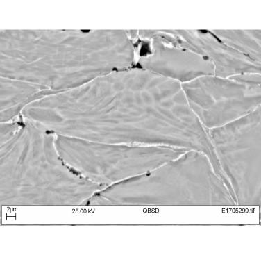

Figure 3. Backscattered SEM micrograph of cold spray deposited Ti-6Al-4V
Figure 4. Backscattered SEM micrograph of cold spray deposited Ti-10V-2Fe-3Al
Figure 5. Cold spray technology proved effective for Ansaldo Energia

Figure 15. Cross-sectional SEM microstructure of interfaces showing Cold Spray (CS) and Laser Assisted Cold Spray (LACS) deposits of Ti6Al4V onto Ti6Al4V substrates
