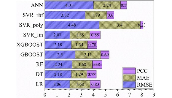

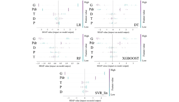

The final dataset, which was derived from the literature and experiments, identified SVM with a linear kernel and LR as the top-performing models based on the Pearson correlation coefficient (PCC) and root mean square error, where the PCC values exceeded 0.8 (Figure 1). In addition, the SHapley Additive exPlanations (SHAP; Figure 2) method helped identify that the type of gas and powder morphology are the top two factors in pore formation.

Figure 1. The Pearson correlation coefficient (PCC), mean absolute error (MAE), and root mean square error (RMSE) values for all the employed ML models: LR, DT, RF, GBOOST, XGBOOST, SVR_lin, SVR_poly, SVR_rbf, and ANN.
Figure 2. The figure showcases the hierarchical importance of the input features obtained from the SHAP method for the top five models: LR, DT, RF, XGBOOST, and SVR_lin. The hierarchical importance indicates which factor contributes the most to the formation of porosity during cold spray deposition of the Cantor alloy. Here, 'G' refers to gas type (He or N2), 'Pdr' refers to powder morphology, 'D' stands for stand-off distance, 'P' represents process gas pressure, and 'T' denotes process gas temperature.
