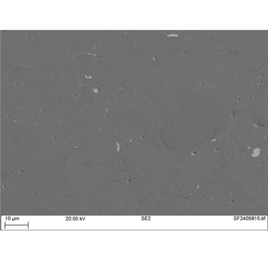

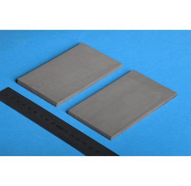

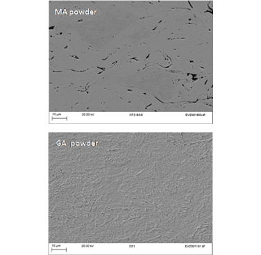

ODS PM2000 was deposited with measured density ~98% for MA powder, and >99% for GA powders (Figure 1 showing SEM microstructure). Deposition efficiency was found to be higher than 80% for both powders. The production CSAM plates have been successfully demonstrated for two ODS PM2000 powders, producing material that is sufficiently dense and free from defects such as cracks or delamination. This suggests that larger and thicker deposits could be achieved using this material, as will be required for CSAM of larger, freestanding components.
Heat treatment led to the disappearance of meso- and microstructural features in the CS-deposited material, with improved metallurgical bonding along particle boundaries and a slight reduction in porosity. This treatment significantly enhanced tensile strength, achieving 1039 MPa for MA powder deposits and 725 MPa for GA powder deposits (Figure 2 showing CSAM ODS PM2000 plates).

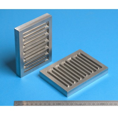

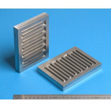

For the demonstrator parts, thick deposits of SS316 were successfully created with high density and no visible delamination, followed by machining of grooves for creating internal cooling channel features (Figure 3).

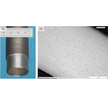

Upon the successful completion of Phase 1 studies on the cold sprayability of ODS alloys, Phase 2 involves investigating the RAFM ODS Eurofer97 alloy using TWI’s Titomic TKF-1000 system. The cold sprayability of ODS Eurofer97 has been successfully demonstrated using both MA and GA powders. With the optimal set of process parameters, ODS Eurofer97 deposits exhibited a measured density of >99% with no signs of delamination or cracks. The deposition efficiency was found to be >75%, with a deposition rate of 1.1 kg/hr. Figure 4 shows an ODS Eurofer97 blanket tube demonstrator, together with a representative cross‑sectional microstructure. Similar to ODS PM2000, post-deposition heat treatment of CSAM ODS Eurofer97 resulted in significant improvement in tensile strength, reaching 940-1000 MPa.

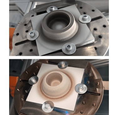

Furthermore, toolpaths have been developed to create high-fidelity, free-standing geometrical features of intermediate complexity. These build strategies are utilised to produce small-scale demonstrator components, including straight walls, cylindrical walls, and cones (Figure 5).
Figure 1. Microstructure of as-deposited cold spray ODS PM2000 using MA and GA powders

Figure 2. Cold spray additive manufactured ODS PM2000 plates

Figure 3. Cold spray deposited SS316 onto aluminium substrate, following machining of the cooling channel grooves

Figure 4: (a) ODS Eurofer97 blanket tube demonstrator (300mm long, 25.4mm inner diameter, 3.5mm thickness), with the outer surface of the lower end machined, and (b) representative optical cross-sectional microstructure of a tube section

Figure 5. Example demonstration components produced using cold spray additive manufacturing
