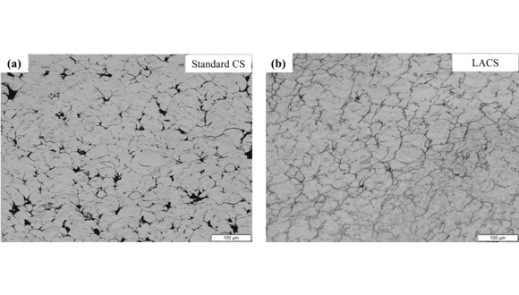

The preheating temperature of the substrate and the spacing between deposition tracks are identified as key factors significantly impacting coating characteristics, including adhesion, microstructure, and mechanical properties. Figure 2 illustrates a comparison of Ti6Al4V deposits in conventional CS versus LACS, highlighting a significant reduction in porosity (2.3% in conventional CS deposits vs. 0.4% in LACS deposits). Figure 3 presents the enhanced interfacial adhesion achieved through LACS when compared to CS.
Figure 2. Optical micrographs of Ti6Al4V deposits comparing mesostructure, illustrating the presence of pores/defects in standard Cold Spray (CS) and Laser Assisted Cold Spray (LACS) deposits

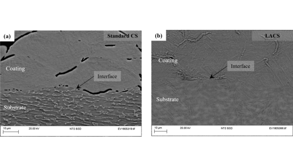

Figure 3. Cross-sectional SEM microstructure of interfaces showing Cold Spray (CS) and Laser Assisted Cold Spray (LACS) deposits of Ti6Al4V onto Ti6Al4V substrates
Key contributions of this study include enhanced coating-substrate adhesion through extensive interfacial mixing, a substantial improvement in deposit density, and valuable insights into the effects of residual stresses.
