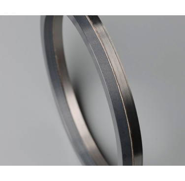

- TWI Pioneers New Dissimilar Weld for European Space Agency
The combustion chamber is the hottest part of a rocket’s engine and the higher the temperature, the more efficiently it can perform. This means that there is a desire to increase the chamber’s operating temperature through the use of highly heat-resistant materials. C103, which is an alloy of niobium with hafnium, has been used with R512E di-silicide coating for chamber temperatures up to ~1350°C. However, ceramic material such as silicon nitride (Si3N4) is able to withstand heats of around 1500°C and higher, making it particularly suitable for rocket combustion chambers. However, ESA wanted to join this ceramic with C103 to avoid the challenge of manufacturing monolithic ceramic combustion chambers. Although this had never been achieved before, early tests at TWI demonstrated a solution to this challenge, successfully joining C103 alloy with silicon nitride for the first time in our history, using diffusion bonding and vacuum brazing processes with the aid of interlayers. The joining of these dissimilar materials was demonstrated in the form of rings that are representative of thruster combustion chamber joint geometry (Figures 2-3).

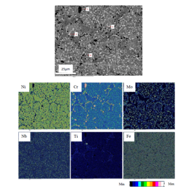

- GEO-COAT Project: PM HIP metal matrix composites (MMCs)
As part of the Geo-Coat (Development of Novel and Cost-Effective Corrosion Resistant Coatings for High Temperature Geothermal Applications) project, TWI undertook a microstructural characterisation of Inconel625 (IN625) and Ti-6Al-4V (Ti64) base metal matrix composites (MMCs) consolidated using uniaxial hot pressing (UHP) and hot isostatic pressing (HIP). MMC powders were mixed with different amounts of ceramic particles before being consolidated by UHP and HIP processes. The microstructures were then characterised using scanning electron microscopy (SEM) and X-ray diffraction (XRD) while the hardness and impact toughness were assessed using Vickers microhardness and Charpy impact testing, respectively, and the rate of erosion was obtained using erosion-corrosion test results. The main objective of this work was to further characterise the PM base MMCs to evaluate their microstructure, tribological, and mechanical properties (Figure 4).

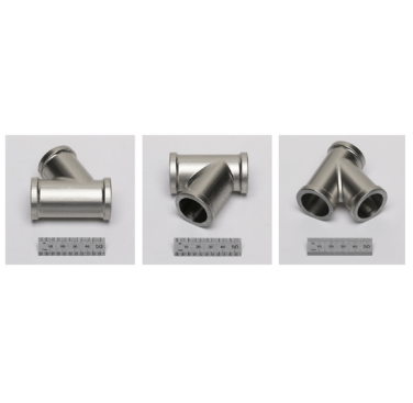

- Near Net Shape Powder Metallurgy Hot Isostatic Pressing
The European funded H2020 SUPREME (Sustainable and flexible powder metallurgy processes optimisation by a holistic reduction of raw material resources and energy consumption) project investigated the use of advanced manufacturing processes to improve manufacturing process efficiency and reduce material wastage. This work drew upon TWI’s experience to produce an efficient manufacturing process for fabricating Y-shaped Inconel 625 (IN625) submarine pipe using NNS PM HIP manufacturing technique. This study focused on understanding the influence of IN625 powder atomisation route and powder characteristics on the microstructure and mechanical properties of HIP’d material fabricated using four different powders, including argon gas atomised (AGA), nitrogen gas atomised (NGA), plasma atomised (PA) and water atomised (WA) powders. All four powders were characterised, including chemical analysis, physical properties (apparent and tap density and flowability), powder morphology and particle size distribution (PSD) (Figure 6). The microstructure of four HIP’d powders is shown in Figure 7. The results of as-HIP’d tensile properties confirmed that PA powder possessed the best balance between strength and elongation, with superior properties if compared to the minimum specification of wrought IN625 (Figure 8). With PA chosen as the favoured powder for the application, we designed a capsule (Figure 9) and produced prototype pipes (Figure 10) that showed good geometrical accuracy with a reduced buy-to-fly ratio of 2:1, which is more than 3.5 times lower if compared to the conventional manufacturing process.

Figure 2. Dissimilar joining for ESA combustion chamber
Figure 3. Dissimilar joining for ESA combustion chamber
Figure 4. Geo-Coat project: BSE image IN625+10%TiB2 consolidated via HIP and the corresponding EDS maps of various elements

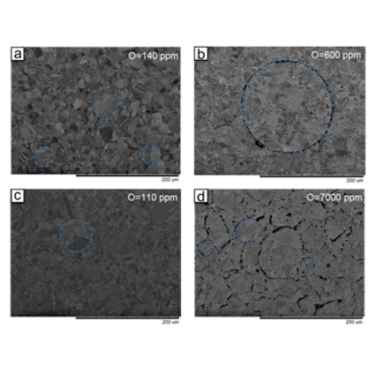

Figure 6. Powder morphology of (a) AGA; (b) NGA; (c) PA; (d) WA (left); PSD of the four powders (right)
Figure 7. SEM backscattered micrographs of as-HIPed AGA (a); NGA (b); PA (c); WA(d); (PPBs highlighted in blue)

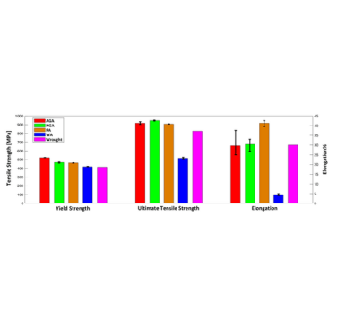

Figure 8. As-HIP Room temperature tensile properties of IN625 powders vs wrought minimum specifications

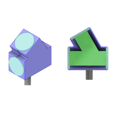

Figure 9. 3D CAD drawing of the designed capsule
Figure 10. Submarine Y-shaped IN625 pipes produced using NNS PM HIP technique
