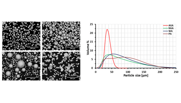

The first step of the manufacturing process consisted of the powder characterisation. A detailed powder characterisation was performed on the four powders, including chemical analysis, physical properties (apparent and tap density and flowability), powder morphology and particle size distribution (PSD). The powder morphology of Figure 2 shows that PA has a regular shape followed by NGA and AGA with some irregular shaped particles, while WA has a typical irregular shape. PSDs of the four powders highlights that NGA, PA and WA have similar distributions, while AGA has a more narrow distribution with a smaller particle size.
Figure 2. Powder morphology of (a) AGA; (b) NGA; (c) PA; (d) WA (left); PSD of the four powders (right)

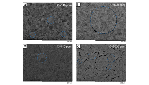

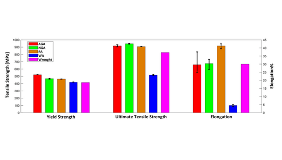

The microstructure of the four HIPed powders is reported in Figure 3. HIPed PA microstructure shows the least amount of prior particle boundaries (PPBs), while WA is characterised by the strongest presence of PPBs. The results of as-HIPed tensile properties confirm that PA powder possesses the best balance between strength and elongation, with superior properties if compared to the minimum specification of wrought IN625 (Figure 4).
Figure 3. SEM backscattered micrographs of as-HIPed AGA (a); NGA (b); PA (c); WA(d); (PPBs highlighted in blue)
Figure 4. As-HIP Room temperature tensile properties of IN625 powders vs wrought minimum specifications

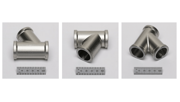

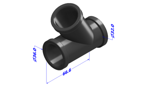

The NNS PM HIP manufacturing process involved the design of a capsule (Figure 5), powder fill, degas, crimp, HIP and machining off the sacrificial canister to attain a netshape part geometry (Figure 6).
Figure 5. 3D CAD drawing of the designed capsule
Figure 6. Submarine Y-shaped IN625 pipes produced using NNS PM HIP technique
The prototype pipes produced during this work showed good geometrical accuracy with a reduced buy-to-fly ratio of 2.1:1, which is more than 3.5 times lower if compared to the conventional manufacturing process. To conclude, NNS PM HIP technique has been successfully adopted to manufacture IN625 Y-shaped submarine pipe with a low buy-to-fly ratio and superior mechanical properties.
