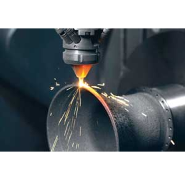

Laser ultrasonic testing was performed as part of this project, which ran from 2016-2019 with the aim of creating a new hybrid additive and subtractive manufacturing system capable of integration onto any machine tool platform. The project team sought to increase the impact and uptake of hybrid AM technology for a wider range of machine tool platforms, processes, materials and applications through the development of a single manufacturing system capable of producing large, high volume and complex components without the need for materials handling or post-processing. The multi-tool platform used directed energy deposition (DED) additive manufacturing with an integrated machining process to enable fully finished components to be produced. The laser cladding technology employed offers high deposition rates, material flexibility, minimal substrate interaction, and is also an effective repair technique (Figure 1).

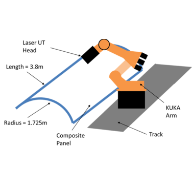

The ACCURATe Project (2017-2022) used laser ultrasonic testing to address a non-destructive testing challenge for the aerospace industry. Composite materials such as carbon fibre reinforced polymers and hybrid polymer-metal multilayer sandwich structures (laminates) has been shown to offer much greater fatigue strength to weight ratio and elastic modulus to weight ratio than metals. Because of this, they were highlighted as a key pathway to reducing aerospace fuel costs and emissions, with state-of-the-art aircraft containing up to 80% by weight of such composites in their load bearing structures at the time of the project. However, there were two key barriers to overcome: (i) they are more expensive that traditional aluminium alloy structures and (ii) the risks of the development of both internal defects and impact damage leading to structural failure are higher. This TWI-led project created a prototype system for fast and contactless NDT of these structures during manufacture, including the design of generating and detection laser systems, the creation of analysis software (with post processing applications), and the design of an inspection cell with a robotic arm to manipulate the laser systems (Figure 2). The innovative system was validated through the inspection of a fuselage barrel demonstrator component panel.

Figure 1. OpenHybrid project
Figure 2. A diagram of the ACCURATe project inspection system
