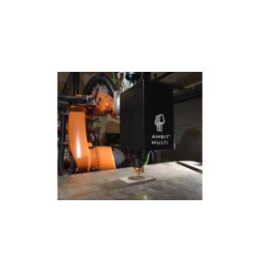

TWI collaborated with Epoch Wires Ltd on the Nano-Ti project, investigating methods to control grain growth of additively manufactured components. The project investigated doped Ti6Al4V wire manufactured with small quantities of grain refiners, with the aim of making minor modifications to alloy composition and reduce columnar grain growth. The project determined the most efficient quantity and type of grain refinement addition and its resultant properties across a spectrum of different wire-based AM processes, including DED-LB, WAAM and DED-EB (Figure 1).

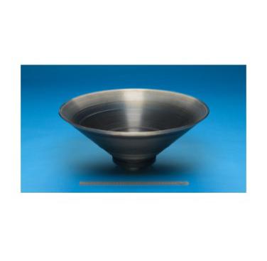

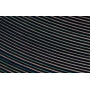

Our experts manufactured the frustum of a cone using 3mm Ti-6Al-4V wire from Perrymans Inc. to demonstrate the capability of the xBeam system, which had already shown that it has the potential to produce refined 𝛽-grain structures
The system was used to manufacture a 460mm x 190mm titanium frustum of a cone with a wall thickness of 4.5mm in less than 2.5 hours of continuous build time. This showed the potential to speed up the production of additive manufacturing using the novel coaxial electron beam directed energy deposition wire (DED/w) system from xBeam. TWI is one of around just five organisations anywhere in the world to have access to this ground-breaking coaxial electron beam wire additive manufacturing (AM) system.
The aim of the work was to develop an enhanced capability and flexibility for large scale additive manufacturing with coaxial-wire DED technology, as well as demonstrating the technology advantages and potential (Figures 2 and 3).
Figure 1. Nano-Ti Project
Figure 2. Cone frustum manufacture
Figure 3. Frustum detail
