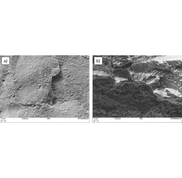

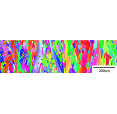

This project used both destructive and non-destructive testing methods to investigate resistance of 316L stainless steel and Alloy 718, produced as AM builds, to HE (Figures 1 and 2). Our AM experts produced the parts to be tested using laser-powder bed fusion (L-PBF), with the tests showing that L-PBF 316L and Alloy 718 are potential candidates in environments where HE is a concern, provided a suitable fabrication route (including chemical composition and heat treatment) is used.

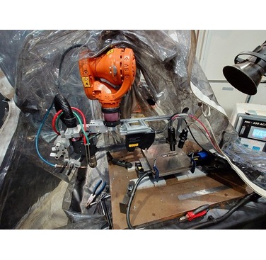

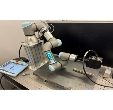

This work investigated laser profiler surface scanning as an indirect monitoring technique and laser ultrasonic testing (LUT) as a direct technique (Figures 3 and 4). These allow the inspection strategy to be determined based on the selected DED technique and build parameters to minimise disruption. At the time of writing, this project is ongoing, with laboratory trials proving both 2D line profilometry for detecting weld bead shape continuity, and LUT can detect flaws in DED produced parts. The next challenge is performing these tests in-situ during manufacture…

Figure 1: EBSD inverse pole figure (IPF) map of Alloy 718 L-PBF taken transverse to the building direction in the as built condition
Figure 2: Scanning electron micrographs of the fracture surfaces of Alloy 718 L-PBF specimens printed with the longest specimen in the horizontal (Y) direction. Specimens were heat treated in accordance with API 6ACRA N07718 150K. Nominal scale bars are shown:
 a) Image of specimen Y9 tested in air taken near the edge of the specimen, showing evidence on microvoid coalescence indicative of a ductile failure;
 b) Image of specimen Y2 tested under CP taken near the edge of the specimen, showing brittle fracture surface indicative of hydrogen embrittlement
Figure 2: Scanning electron micrographs of the fracture surfaces of Alloy 718 L-PBF specimens printed with the longest specimen in the horizontal (Y) direction. Specimens were heat treated in accordance with API 6ACRA N07718 150K. Nominal scale bars are shown: a) Image of specimen Y9 tested in air taken near the edge of the specimen, showing evidence on microvoid coalescence indicative of a ductile failure; b) Image of specimen Y2 tested under CP taken near the edge of the specimen, showing brittle fracture surface indicative of hydrogen embrittlement
Figure 3: 2D line laser profiler
Figure 4: DED-arc 2D line profilometry
